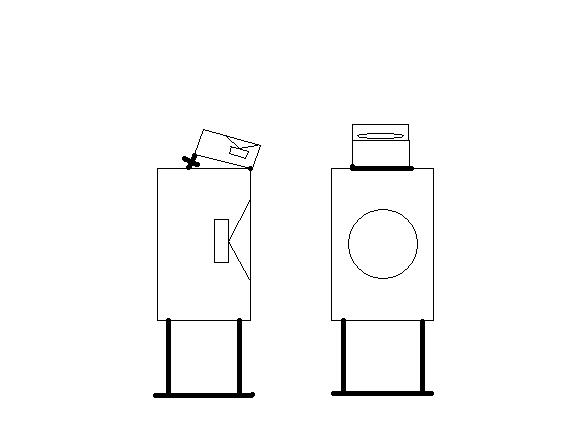

decware is a dipol, placement not near wall and furniture,
i don´t have the room, only 22 sqm. 52 Hz is not enough.
my double horns are push pull, bipol, 35 Hz
your horn: try a simple horn "Lampenschirm" plastic
AH ~4-5 cm diameter, AM 30-50 cm and place it above the center of the driver, distance, try -2 -20 cm ),
like the reflector of the Audiovector Symphonic

An explaination for those who haven´t understood yet what that´s all about:
The aim of directing a beamy fullrange driver towards the ceiling, in contrast to the Decware, isn´t getting a dipole-like sound without huge baffles or huge bass drivers / amps. Large open baffles with driver placement close to the inside give some airiness I don´t find unpleasant, but as soon as the acoustic short circuit to the outside becomes too short, this gives a spacial effect that reminds me a bit of cicada singing. What I (and graaf) want to achieve is maximum realism (which doesn´t mean getting as much spacial information out of the recording as possible).
Oliver

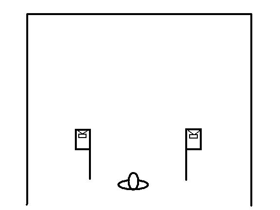

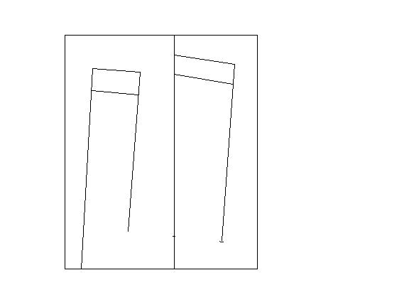

graaf
these are contradictory claims
if you place omnidirectional speaker againt the wall, you will hear direct sound mixed with large amount of first early reflections from the wall which is very detrimental
The loudspeakers are to work on the floor – the driver is only 20 cm above the floor – and against the wall.
my first and main aim was to eliminate the detrimental effect of early floor and ceiling reflections without resorting to unavailable true linesource

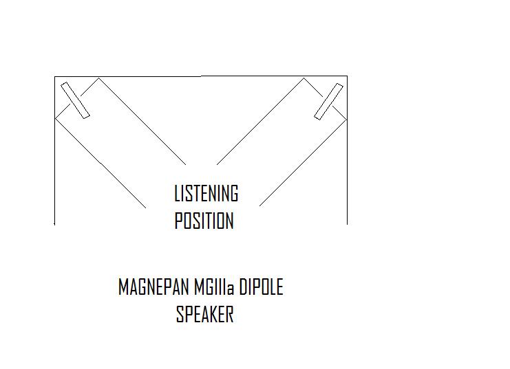

I do not mean to Hijack this thread, but I have always been aware of the potential sonic effects of speaker placement in a rectangular room. The Beveridge paper has re-piqued my interest in the issue.
I have always wanted to experiment with the placement of my magnepan dipolar speakers. Two square, planar, radiating surfaces in a rectangular room.
Has anyone ever experimented with placing these speakers in the corners as shown below? Seems like it would be interesting to find out how this would sound. I am in the middle of a cross country move and cannot try this for a few more months...
Has anyone tried this before?
Incidentally, I also have a pair of MMG-Ws that are designed to be mounted on a wall like a window shutter...seems like it would be a perfect application...
I have three different Magnepan speakers - a pair of the MGIIIa, MMG-W, and .5. I love the sound of these speakers, but wish I could somehow overcome the placement issue...the WAF is somewhat low in my realm.

I have seen it done for dynamic dipole woofers, but not for planars and not for the full range.john65b said:Has anyone tried this before?
something similar, the so called "Stereo Unlimited tweak": http://www.integracoustics.com/MUG/MUG/tweaks/facing.html
Iwao Furuyama proposed this for his FAL Flat S a while ago.
The current status of my work with the HX160: When it was tested in K+T a while ago they wrote its imaging is "not as good as that of other fullrange drivers", which was very politely expressed. With the ceiling firing method one one has to find the middle between "too diffuse" and "dual mono", which works more or less, but not absolutely satisfying. But reversing them so that they face the rear wall is like sunrise. There has to be some distance, however, and eliminating the direct sound will be a challenge.
So all the different placements have to be seen in the context of a specific driver.
Oliver

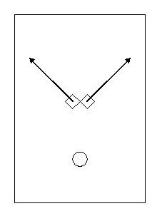

el`Ol said:
...and eliminating the direct sound will be a challenge.
Simple but effective:
yes indeed
You may also try something like Jim Kyle's "Stereo sixteen":
see: http://www.roger-russell.com/columns/columns.htm#sweet
the two channels arranged in a single angled cabinet. The system was designed to face into the wall and, in fact, was recommended to be placed against the wall. All of the sound was then reflected from the wall. This arrangement looks similar to a Bose 901 but, of course, the Stereo Sixteen contained both channels.
best,
graaf
Your proposed positioning is similar to what Schallwand proposes...
http://www.schallwand.com/4957.html
Lowrider said:Your proposed positioning is similar to what Schallwand proposes...
interesting are those people from Schallwand I have to admit
and interesting omnidirectional Shahinian-like speakers
the speaker positioning is also interesting although signifficantly different from the one I propose
in Schallwand positioning of omnidirectional LS one would get a lot of early lateral reflections and reflections off the wall behind the listener
is it recommended for their Kamasan/Tudusan? or only for their highly directional fullrange dipoles?
best,
graaf
