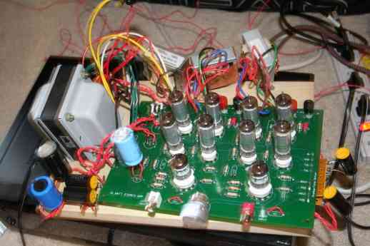

At the advice of on of the forum members I have ordered two Edcor CXPP25-8-5K output transformers and hope to use them in my kit.
I do need to ask question though and I ask it simply to assure myself. Given the specs of the Edcor transformer, which are:

Can I simply swap out the OPTs or do I need to do some mods to adapt the amp to receive them? Likely I did not give enough data here; of so let me know what other data I need to give you. I can provide the kit schematic if that helps. My skills just are not up to the level that know this.
Many thanks for any help.

It uses 2 x 6005 tubes in PP parallel. You need the 2500 ohm primary transformers. Probably why they spec that amp at 4 ohms (5000:8 loaded with 4 = 2500 primary). They should work fine.

I see no reason why you can't use the Edcors without modifications as long as you do not use the screen taps. If the amp uses feedback form the speaker secondary, then you might have to adjust the feedback resistor since the Edcors are 8 ohm instead of 4 ohm like the originals. If you desire to use the screen taps an make the amp into an ultra-linear, then other modifications will be necesssary. Perhaps a schematic might help.

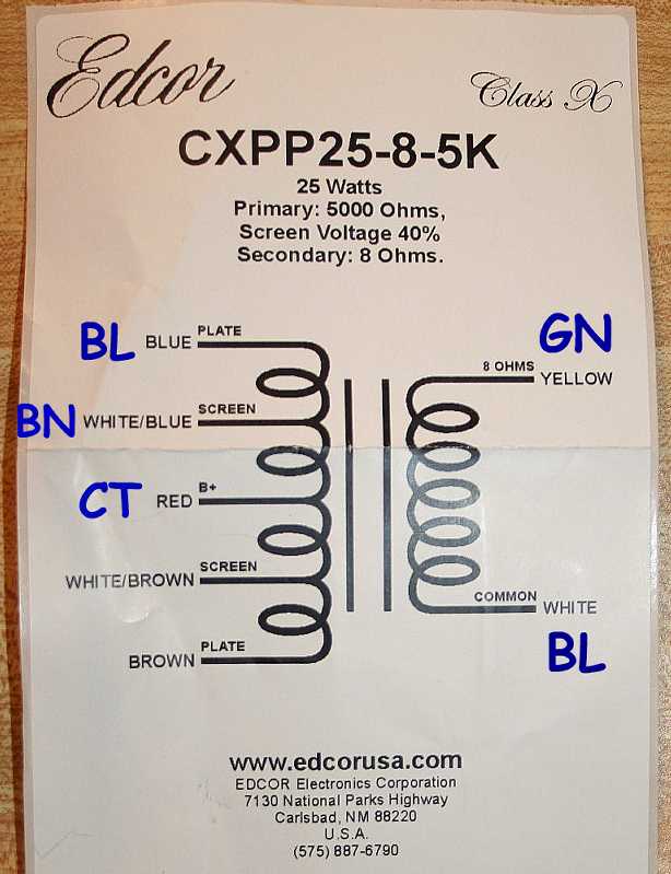

Output transformer connections? Help!!!!
Hey, I got the Output Transformers in tonight and I am listening to them now. I immediately noticed that I have to turn the volume up louder to get the same level out as I had with the previous OPT's in. I was wondering if you noticed the same with yours? I attached the Edcor sticker to show you where I placed the wires in the location on the circuit board.
How did you wire your output transformers in? I noticed that there is also a brown wire and a white and brown striped wire as well. I just capped these off and did not connect them into the circuit.
Should I have? Is this why I have to crank up the volume to only get a minimal amount of sound?

OPT stock schem
I'm just really confused about where to hook each wire on the schematic for the OPT's. Especially since there are a total of 5 wires on the left side of Edcor's schematic and 3 on the left side of the K16 amp.
Help!!!!!
I also am attaching a blown up portion of the output section on the stock K16 amp, if this will help with telling me where to solder each wire!
Thanks in advance for your help!!

Move the BN wire off of the white/blue transformer wire,and move it to the brown transformer wire.
the white/blue and white/brown are the UL taps..insulate them well,since you won't be using them.

DigitalJunkie's got it right, and some point once you have sorted out the current issues and listened for a while you might just want to try UL connection. To do that you first have to disconnect the screen grids of your 6005 output tubes from the screensupply, then connect the white/blue wire to both screens of the tubes with the blue wire plate connection, and the white/brown wire to the screens of the tubes with the brown wire plate connection.
There is a small possibility of oscillation which should be easily resolved with just a minor change to the amplifier's existing compensation with this new transformer in either pentode or UL connection - if it does not show any signs of instability with pentode connection, it should be less likely in UL as the overall loop gain will be a few dB lower.
Screen voltage rating is same as the plate voltage rating so you should be ok there.
Yes, you don't use the striped wires. Cap them off. The Red, Blue and Brown wires ONLY are used in the "stock" transplant. On my kit it's like wire color for the original stock transformers and the new. And, the PCB labels the conections by color too.
