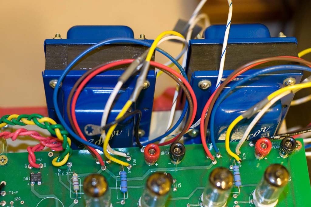

Still waiting for My Edcor Opts
As raved about above, I called Edcor and ordered a set of opts. Has anyone used molex connectors for quick disconnect of circuit boards. I am tempted but am cautious. I also wondered what type of a beating these tubes can take. I have already removed them from the board a couple of times for retro fitting in a cabinet. I assume that they are more fragile when hot so I don't move the unit shortly after operating. It also gives the Caps a chance to discharge due to the lack of resistors.

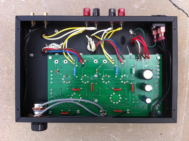

Hi All,
I've just purchased the CXPP25-8-5K OT's for my K16LS, but am having trouble installing them.
After reading through the advice on this thread, I connected up both Edcor OT's with the red, brown and blue wires connecting to the corresponding RD (red), BN (brown) and BL (blue) on the board. Then I connected up the OT's yellow and white wires to the corrosponding GN (green) and BL (black). The white/blue and white/brown screen wires have been taped off.
My problem is when I turn on the amp, I immediately get a fairly loud hum, and can just faintly hear the music. I double checked all the connections, but couldn't get it to work.
When I swapped back to the original OT's, it worked fine. This is my first adventure into DIY tube amps, and I am probably just missing something basic here, but for the life of me, I can't work it out!
If anyone can help me, that would be fantastic!
Paul

I've attached a photo showing how I have wired them in, which as far as I can tell is correct. I also tested the connections with a meter to make sure the solder joints are ok.
I still have the problem that I get a reasonably loud hum as soon as the amp is switched on.
Another weird thing is that if the ground lug on the right channel touches the red speaker plug, the hum disappears and I get sound out of the right channel only. The most worrying thing is that the power transformer starts to smell like its overheating after a few moments, so I switch it off after a few seconds.
Again, if I switch back to original OT's, everything is fine.
Sorry to dig up an old thread. I'm completely new to tube amplifiers and was wanting to do this Edcor Output Transformer mod listed. I notice the output is rated for 8ohms, however, I would like to power 4ohm speakers. Can this be done with the following transformer as a straight drop in without additional modifications: CXPP25-8-2.5K?
I think it is the other way around. I think that would give you a 1.25K load on a 4 ohm speaker. (The ratio between them stays the same) There is this guy CXPP25-6-7.6K with a 7.6k load at 6 ohms. That should give you about 5K on the plate with a 4 ohm speaker. There is also it's little brother GXPP15-4-5K which has a 5K load on a 4 ohm speaker. I ordered a pair of the 10 watt GXPPs for my S5 K-12, but they have not come yet, so I don't know if they are a substantial improvement over the stock ones. I will post my findings when I know.
Thanks Jpeg! I get how it works now and I'm assuming I can just swap these in without any further mods elsewhere in the schematic? I was looking at the GXPP15-4-5K but I noticed that it's only rated for 15W but the K16 is 16W...does the 1W make a whole lot of difference?
You should be able just hook it up as is. The Edcore will have a ultra-linear tap that you won't use, make sure you insulate this well, it will have somthing like 250 volts on it. I wouldn't worry about using a 15 what transformer on this particular amp. In a review of the K12 http://diyaudioprojects.com/Tubes/K-12M/audioXpress-review-of-S5-Electronics-K-12M-Tube-Amp-Kit.pdf they say that it actually only puts out about 4.5 watts and in order to get 8 watts out of it, you have to push it to the point of 28% distortion. I have not seen measurements on the K-16ls but I would expect them to be similar. I would expect better bass performance from the larger ones though.
