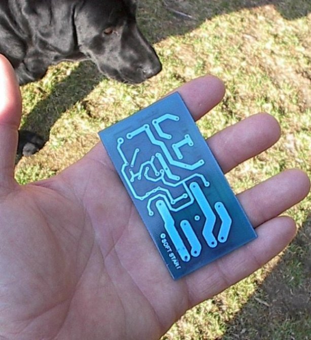

I etch a board every month or two and have found that I like the method on Tom Gootee's page: http://www.fullnet.com/~tomg/gooteepc.htm#1
For toner-transfer, I've tried magazine paper, photo paper, and transparencies. All of them work, and can be bought locally, but I ended buying some press-n-peel blue and have not looked back. Press-n-peel works great and I highly recommend it. You will always have to go back with a paint pen (better) or a sharpie (passable) and touch up your traces, even with press-n-peel.
For etchant I use the 2 part hydrogen peroxide ($0.77 at wal-mart, 1 part muriatic acid ($4.99/gal) at the local hardware store. It's not the fastest I've used (faster if warmer), but it is inexpensive and available. I try to use a little as possible to get the job done, and I dilute it with a gallon or so of water before disposing of it in the toilet.

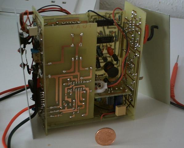

Untill I started producing boards using a software package, all my attempts were hand drawn using "Overhead projection" type pens, and transfers for circles and I/C,s. I am not saying it is easy to produce good artwork direct on to the copper this way but the image I have attached is all done this way. The secret is to clean the copper first. I use an "abrasive kitchen pad, you know those green things" and then clean the board with paper towel and isopropanol. I use a low voltage but high speed handheld drill for all holes.
You don't need any expensive gear to get started, it will take practice and you will have failures but it is worth it. And if you fancy using a PCB package on your PC I can recommend www.diptrace.com . It's freeware and excellent.

A board the size of the one MJL21193 shows would need about an egg cup full of etchant in a margerine tub to produce. There is far worse goes down drains.
