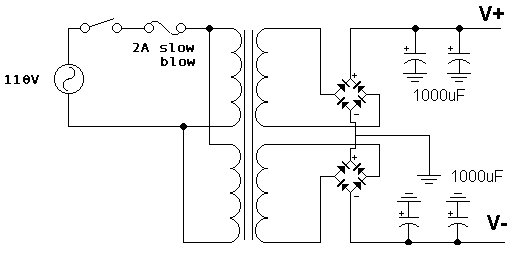

What are the differences between a power supply using 2 rectifier bridge as shown on the schematic versus a power supply using only one ?
Your help is greatly appreciated ! Thanks !

The deal here is that since you have separate "virtual ground lines" from each secondary, you don't get a lot of current flowing back and forth which typically puts noise down the ground line. In short, you actually get control over where you place the ground line. Draw the schematic with one bridge and see what happens (by shorting the two secondaries as a center tap -- the center tap is the ground. Consider how the current will flow back and forth as the diodes switch on and off -- not optimal. Ideally, you don't want current to flow in the ground at all, or at least have control over how this happens which is impossible with 1 bridge.
To make this work, you need to have the secondaries come out of the transformer as shown, but you don't need a split primary. (Thus, a Center Tap transformer will not work, so upgrading old equipment is not always possible)
Petter
I forgot to put in the downside (which is not huge) which is that you get an extra diode drop. This means more power is lost in the power supply.

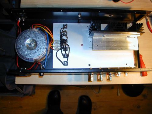

I'm sitting here wondering why I get only +23,2 v and -23,2 v after bridges using a 25+25v toroid in the above circuit. What do I do wrong? Shouldn't I get +35 and -35 volts?
This is going to be a three channel Gainclone amp.
I guess I wired the secondaries from the toroids wrong...?
/Jan

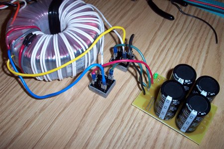

btw, here's my current Power Supply setup

If one toroid feeds two channels do I need two bridges or four bridges with the above circuit?
I my GC I use six bridges for three channels (see pic), and I guess this is the way it should be. But I'm in doubt now cause I keep blowing my fuses after having unwired all 6 bridges and wired them up again, cause I was unsure on my wiring with those 23 volts DC before caps mentioned before ...
Basic electronics, I know, but electronics is my Achilles Heel...

I don't know if Petter's answer is totally right but not very wrong anyway. One extra thing which isn't mentioned. One bridge results in half wave rectification. What happens if you only take out positive voltage? How do current travel in the windings?
You are a little bit nicer to the transformer (less heat) with two bridges and you creates less overtones towards the mains. I don't know big the difference is though.
The disadvantage with two bridges is losses in a extra recifier brigde, also the extra cost...
Another property of the two bridge configuration is the lower voltage across the diodes (half of the voltage compared to the single bridge configuration). Though I do not know exactly the effect of this...
At least you should take this in consideration while chosing the diodes (max. voltage ratings).
Fedde

When I use double bridge rectifier, I putt in count (and possible oscillation/your idea) double number of nonlinear element (diode). When I use single bridge (or 4 diode) my circle of energy flow is shorter, isn't? If we think about GC like minimalist amp, why we complicated with to many diodes? Price here is not only 4 diode more in circuit. Price is posibility of bigger ground loop problems, unstability-oscillation etc. IMO
Regards
Hm, you get more losses in the bridges with two bridges, but as I said earlier the transformer get less losses.
For normal "light duty" I think that it doesn't matter, only more expensive with two bridges...which is nothing compared to the whole cost of an amp.
