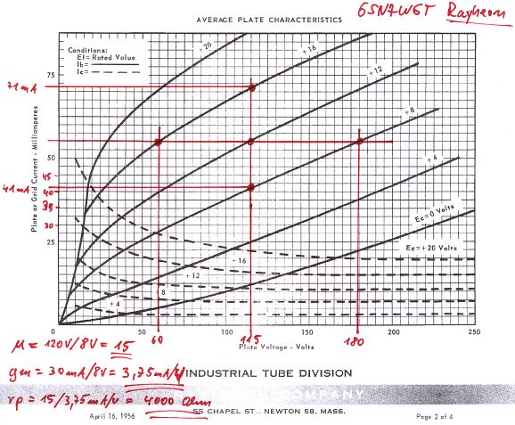

Looking at the 6SN7GTB curves, page 4 top, we could call the plate voltage axis the g2 voltage axis for our pentode (assuming the actual pentode plate V does not have much effect on the current for the moment). The plate current axis would be our g2+plate current for the pentode. Operation would be along a +300mV char. curve.
Comparing this with the page 4 bottom char. curves (negative g1), it does look like the (+g1) char. curves are straightened out considerably, so the g2 now appears to be having a more linear affect. But I don't think you can say that a positive electrode prevents outer electrodes from having any influence, otherwise the curve would be horizontal. (and the spacing betweent the 6SN7 curves for +g1 would be constant too, which clearly are not)
The screen current however has not been accounted for, and would still be increasing dramatically as the real pentode plate voltage drops. So the pent. plate current "hfe" will likely still droop

Hi Darius,
Nonsense? 😕 The curves in page 4 are pentode (transistor) like at positive grid voltages!
Thanks for the example.😀
Gee, don´t let yourself get fooled by the scale. The curves shown (and their spacings) are just sequels (except for the knee) of the ones "on the other side" of Eg=0V, means Eg1 being held negative.
Please have a closer look, and if still in doubt, please just compute mu, gm and ra at some points and you will understand that what you see has nothing to do with pentode behaviour (like extremely high plate resistance and mu). They are not too far from just normal / standard operation coefficients of type 6SN7.
Tom
Hi Darius,
please notice that the curves for positive Eg values are just in parallel to those of Eg = 0, -5 and -10 Volt respectively, so at least for the straight parts, the three determining coefficients mu, gm and ra coefficients have the same values as with normal (negative) g1 operation, for all practical purposes.
IOW, what you see is, that 6SN7 simply keeps its linear mu _and_ linear gm behaviour also when g1 is held positive. Hence no plate resistance anomalies, either.
So, yes, I still think your argumentation chain is nonsense, because the premise you made it is based on a wrong assumption.
Tom

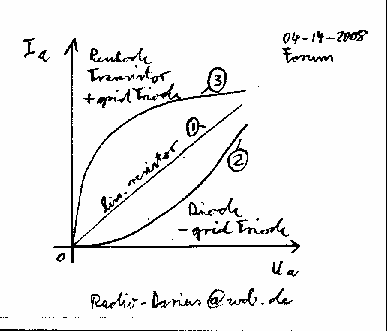

#5 #10 #11
Hi Tom, hope this graph helps understanding. Output curve 1 shows a linear resistor. Curve 2 shows a diode or a triode at negative grid voltages. Curve 3 shows a pentode, tetrode etc., transistor FET BJT or a triode at positive grid voltages. You can adjust the output curve of a triode from diode to transistor by adjusting the grid voltage. Ideally curve 3 is horizontally and starts at 0V. 😉 Kind regards, Darius
Re: #5 #10 #11
Hi Darius,
oldeurope said:
Hi Tom,
Kind regards,
Darius
Okay, the curves may look "pentode-like", but that is just optics, because neither with a pentode nor with a triode having g1 driven positive you want to come anywhere near the "knee" for a practical operation point. But chosing a practical op point for a triode w/ g1 positive - still using 6SN7 as an example - you still will get triode-like coefficients for mu, gm and rp, see attachment.
Actually, you get:
µ = 15
gm = 3,75mA/V
rp = 4 kOhm
over a wide range, which is quite close (factor less than 2) to 6SN7 coefficients at standard (negative g1) operation. Now compare this to any real "pentode like" coefficients.
Again, my points is: The curves may look pentode-like, but don´t get fooled by scaling. For any _practical_ purpose you still get triode-like _coefficients_ when driving g1 of a triode positive, and _that_ is what counts, but not misleading optics by changed scales.

funny...
Hi Tom,
Originally #18 posted by Tubes4e4
Hi Darius,
Tom
it is not just optics, :att'n: it is mathematics.
"Resistor like" means differential and static resistance
do not change with the voltage, see Curve 1.
"Transistor like" means differential resistance increases
at increasing DC- voltages, see curve 3.
"Triode like" means differential resistance decreases
at increasing DC- voltages, see curve 2.
