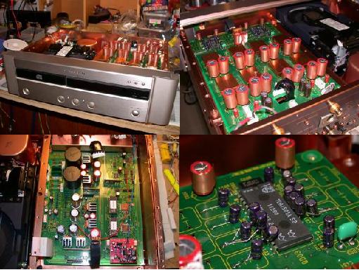

Two times TDA1541.... Probably fed with differential i2s signals.
Sounds familiar ;->
Seems to have a new clock fitted.
Re-program the Eproms of the DSP and it could be made N-OS..

a true classic.......is it yours...?
i see all the elna silmic is replaced by black gates.
and the 2 x 14 decouplin' caps also has been replaced with ?????
that's perhaps the most interesting change - hows the sound before/after...?
this player also uses the cdpro transport unit, but not as topload - marantz build an extremely deluxe drawer mechanisme...smooth!!!!!!
and yes - there's a new clock too...audiocom superclock.
did you dc-couple the player...?

cd7
neh! it not mine..cant afford one..🙂
those are cerafine shielded with copper foil..are they grounded?
the 2 x 14 decoupling caps was replaced with Blackgates non-polarity caps.Black Gate NX Hi-Q

yes, now i see it - but why change silmic for cerafines....????
how about the sound, and what value are the small black gates (14 decouplings) did the sound improve with those?????🙂

This player was a digital dream for me.
But only thing about that player that scares me is a dead laser.
It uses CDM4pro and it is quite heavy to get a new laser pick-up (same as in the plastic CDM4)
It takes me a two years to get two new pick-ups for my Studers that use the same drive as this Marantz.
