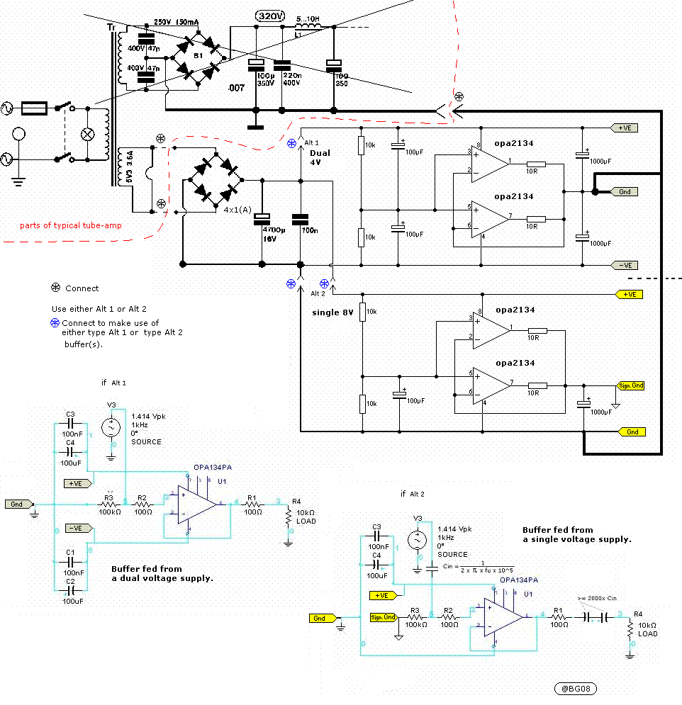

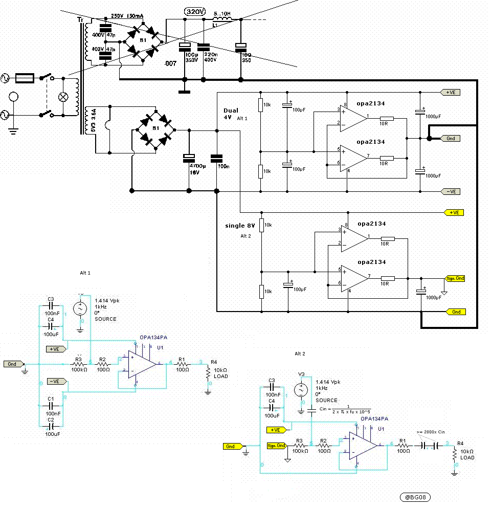

If the preamp stage has a dual supply of the appropriate voltage I can build you a small buffer circuit (no charge).
I will build it and post a pic and you can tell me if you want it or not.
OK, done. I was going to just P2P on a small proto board but my OCD got the best of me. I tested it on my system and bass is clean and plentiful.
OPA2134 buffer
Input impedance: 100k
Output impedance: 100R
DC offset Out_1: 1mv
DC offset Out_2: -1mv
OPA2134 buffer

Can you put up a schematic? Looks like it has some output 'swamping' resistance but be nice to check.

Do you have somewhere in the amplifier you can tap into +/-15 volts (or more) to power the module? Or are you going to put it in its own standalone box? I would imagine a valve amp doesn't have any split rails you can tap into.
I'd like to put it inside of the amp, but chances are I'll have to build it into its own box.
15 volts or more? How much more? The chip is spec'd at 2.5 - 18V input. I was going to test it off of a couple 9V batteries (one for V+, the other for V-)...

Charles,
Very sorry, I meant to make up a wiring diagram and post it.
If you look at the first pic I posted above, the wiring goes......
(5 pos terminal)
IN_1, OUT_1, GROUND, OUT_2, IN_2
(3 pos terminal)
+V, GROUND, -V

Sorry man, I can't read that diagram. I can follow simple instructions and solder pretty decent. I can replace components or make minor modifications. I can even build an amp from a kit. But reading and understanding schematics is beyond me, much less converting schematics into an actual device.
I haven't even looked inside the amp yet, and I don't really even know what voltages are availible... or how to get the required negative voltage.
