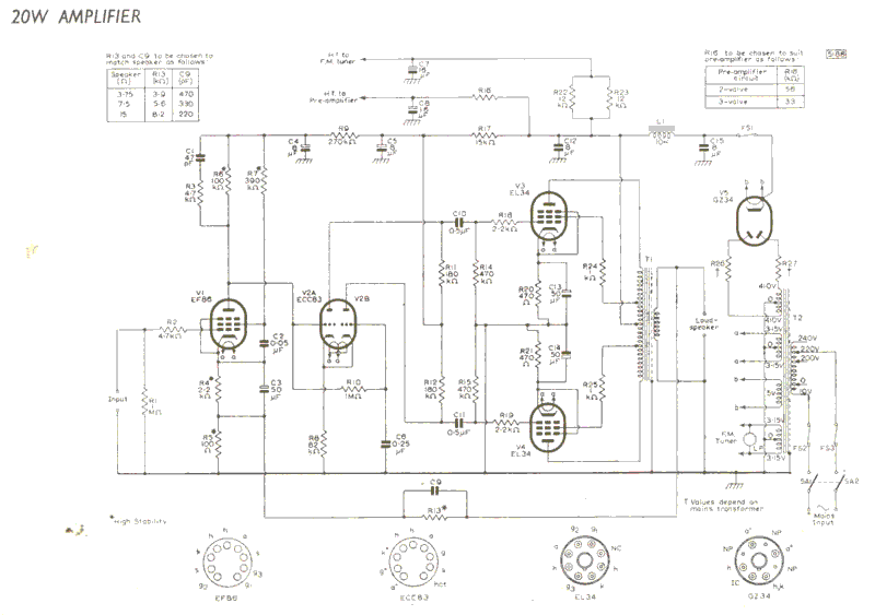

While looking for components to build a valve amp, I came across a guy here in Cape Town, actually not even 1km form me, who got about the biggest collection of valves in Africa, I would say. He used to own his electronic shop but work from his house now.
(Ton Sistilan)
Anyway, while asking him about what he got and what he can suggest to me as a 1st project, he showed me what looks like 2 x Mullard 5-20 amps that he is in the process of restoring. When I asked him about them, he offered them to me, as is, for about $130 a piece without the EL34 valves, off which he can sell me "Electro Harmonics" EL34's for $20 a piece , brand new 1's.
All components are already replaced with high quality new 1's except for transformers, which are still O.K. He did not check the bias on any of them yet or worked on the chasis.
1) Is this a good amp?
2) Is this a good price for the amps?
3) Are these Electro Harmonics valves good and are their price good?
4) Will I be able to use them with 8ohm, 89dB speakers?
5) Will I be able to use them with a high quality pre-amp (XBoSoZ)?
6) Does anybody have a better picture of a Mullard 5-20?
Thanx for all answers.
The Mullard 5-20 is quite an old design, dating from about the mid-1950s, but had quite an impressive performance - 20w output at less than 0.4% distortion (1% at total output of 27w). The pic you show is similar the the originals I have seen, so the ones you've been offered appear to be old, so perhaps they are collectors items!
The amp was quite innovative at its time, offering direct coupling between the first stage and phase splitter, ultra linear output (what Mullard called 'distributed loading'), 30db of feedback, and requiring an input of 220mV for full output (high imp input into 1 meg). Frequency response is fundamentally flat from 30hz to 30khz.
Factory produced units offered a choice of 3, 8 or 15 ohm outputs, and UL tappings at 20% or 43%. You need to check with your friend these details.
I have always had a fondness for these old Mullard designs, but my opinions may be biased by nostalgia - after all, it is an almost 50 year old design! In terms of updating the amp you can increase feedback by another 10db or so before instability sets in, but otherwise major circuit changes would be needed (such as converting the EL34 output stages for normal loading - greater output but greater distortion maybe).

Mullard 20
Hi folks
It uses a EF86 input stage a choice not much comum this days...but that i like! Nowdays the triode imput stage is much more in fashion.
Interestingly the Hiraga designed Lectron amp also use a pentode input stage...in this case a RCA 6SJ7(metal case).
Another positif point in my view, in this design, is the tube rectifier wich is the GZ 34... i still have same waiting for a project (NOS metal base mullards)! 😉 The sound of a vacum tube rectifier is much better that of a solid state one...in my opinion....

Bias on Mullard 5-20
I got my Mullard 5-20's today and want to know the following:
1) I measure 6.9V for the heater supply, is this still o.k. or to much?
2) How can I bring it down to a safe level?
3) How do I measure the bias?
4) What must it be?
5) How do I adjust it?
Thanx for all your help.

1-It's ok...its + 10% trusting in the acuracy of your multimeter..🙄
2-If you care about this 10 %, you need a serie resistor with the filaments.
3-Measure the voltage across the 470 Ohms resistor at the catode of the output stage (this voltage must be 32 V).After calculate the current with the Ohms law....this design use the european standard catode bias..so there are no adjustment.
4-aprox. 68mA
5-See 3..

6.9V is the value one usually measures without the tubes in place.
In case you had the tubes in their sockets it is not O.K although I would lower that to 6V.
Why? Well the tubes sound better and last longer that way.
Tolerance is usually +/- 10%.
As an example: just put a 6DJ8 on a tester with 7V on the heaters and see its' tranconductance go down the "tubes" within the hour.

Quit right, because the previous owner was not finish with his restoration process, last worked on it more then 3 years ago, I 1st tested all voltages without any tubes fitted. When tubes inplace, Vh=6.35V
Now for some other questions: This seems to be not an org. Mullard but rather a diy copy.
1St it got 2 silicone diodes for bridge and also 2 x Output transformers in parallel.
1st OT is quit bulky with only centre tap.
R24 and 25 goes direct to centre tap.
2nd OT , smaller with various tappings.
On 1 amp. anodes of EL34's are connected with series RC.
Rest of circuit is same as Mulllard 5-20 (as circuit on page 1 of this thread)
At moment I only got 1 problem. With or without input signal, I get 10Vpp sine output. With input , output is same , does not change amplitude when changing input.

The poor Mullard is oscilating!!

The Mullard faked!
Well as you say ,your Mullard seem a Mullard clone, but not to similar!
You talk about two output transformers in paralel...rc networks in the anodes of the EL34...nothing of it exist in the original mullard amplifier...so...we are talking of another animal...
See if across the feedback resistor exist a capacitor of 100pF...if not ...put one...and keep as informed!
