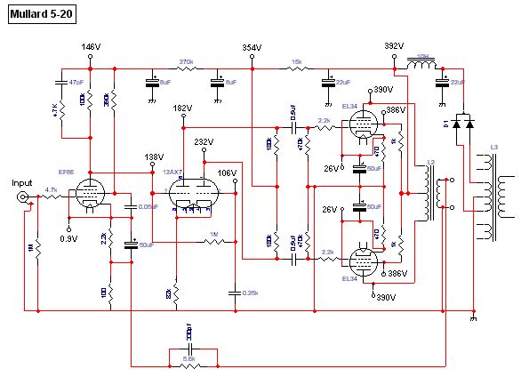

This cap is there, 330pF actually. On this specific amp., it is just the extra OT , else exactly same as org. Mullard 5-20.
Tube_Dude said:See if across the feedback resistor exist a capacitor of 100pF...if not ...put one...and keep as informed!
Tube_Dude said:And the value of the feedback resistor?
For 8ohm speakers, (7.5 on the org. schematic) Mullard recommend 5.6k for feedback resitor, mine is 5.6k.

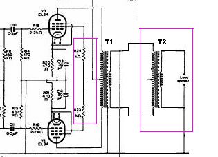

And as I said earlier, R24 and 25 goes directly to centretap on T1.
Why would there be 2 OT's ?

JDev,
I'd hazard a guess that perhaps the first transformer has a relatively high output impedence - perhaps it was designed for a 70 volt line - and thus another transformer is required to drop the output for normal speakers. Of course, the second output tranny is not included in the feedback loop and this will affect the linearity of the response (apart from any mismatch on impedences by this setup).
There is another difference also - the first tranny is set up for normal loading, not UL (distributed loading) of the original Mullard, and that means the cathode bias resistors are wrong, too high really for this kind of working. If you want to sort out any instability you'd need to sort these things before worrying about bus bar connections.
(If all else fails to remove the oscillation, try small caps, a few hundred pfs from each of the EL34 grids to ground, or small caps, 1000pf at 1500vdc working, from each of the EL34 anodes to the centre tap of the first transformer. If the amp is deviating from the original Mullard 5-20 circuit then you cannot guarantee that the same methods used in the original will bring stability to your amp).

Thanx to all for help. Bournville, you did it.
1st tried the "small caps to ground" idea. no help.
So disconnect OT2, problem gone. Connect fat 8ohm resistor, inject 100Hz test signal, appears perfect on scope. Pump up volume, start clipping at 2.4Vrms. So atleast it is working, no I must just get it up to the claimed 20Watts.
What must I do next to increase the output. At 12ohm I got it up till 4.2Vrms, still not 20Watt. Is it all because of the wrong OT, or some other factors as well?

Jdev,
Glad that you've got the oscillation under control, although I can't claim any credit for it!
It is interesting that the output appears to increase with a higher load. Looking back on the altered circuit, I was thinking that perhaps your Mullard had been adapted for PA work rather than normal audio work, which could mean that perhaps the transformer secondary has quite a high impedence (sometimes as much as 500 ohms) because PA speakers often have their own output transformers connected. Likewise, the normal loading as opposed to UL working could be an attempt to increase output at the expense of distortion, not such a problem in a PA amplifier.
In terms of checking, are you are sure of the HT voltage, bias voltage on the EL34 cathodes (check to make sure that operating conditions are not upset by 'leaky' coupling caps) and efficiency of the GZ34? Check the resistance of the output winding of the transformer - is it higher than you'd normally expect for a 3, 8 or 15 ohm secondary? If it is significantly higher it may be the high secondary of a PA transformer, which is why another transformer is connected to bring it down to 3 or 8 ohms.
If it does seem to be a 500 ohm secondary, check the feedback resistor - if it is a value for a 8 or 15 ohm secondary it will be way to low for a high impedence secondary, which would cause phase shift and oscillation in the amp.

O.K. I think I sorted out the impedance problem with the 2 OT's. The 2nd OT consists of 4 x 8.7ohm windings and a 1.2ohm winding. By useing 2 x 8.7 windings in serie, I got the impedance ratio to 5200:8 for the 2 OT's combined. (parrallel) The 1st OT got a ratio of 128:8 and the org. combined ratio was 22500:8
Now I can atleast go to about 18Watt before clipping occur's. Only other problem is loud hum all the time. I also took some measurements, both amps about the same, but am not sure what theoratical values must be in order to compare. I traced the circuit, and except for 2 silicone diodes in place of GZ34, and the OT thing, it is exactly as Mullard 5-20, same component values. The OT do not have 33% taps , so G2 of EL34 now goes to 1k resistor and then to centretap and back to +
Can somebody please check these values and comment on them?

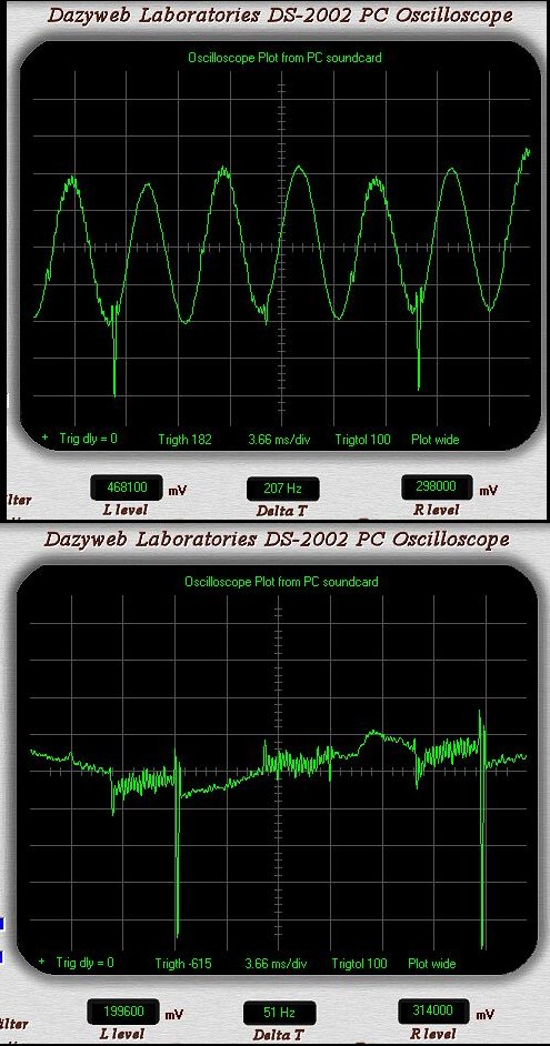

Is the hum 100Hz or 50Hz? 100Hz almost certainly comes from the power supply, 50Hz from poor earthing.
You could probably obtain a bit more HT by increasing the value of the first smoothing capacitor beyond 22uF. If you do a search, and look for "Duncanamps" you will find a piece of freeware called Power Supply Designer. Using this, you will be able to simulate the effect of increasing the reservoir capacitor, although PSUD tends to be a bit pessimistic in practice. It is worth restoring the HT to 433V because the design will then be working optimally. If you do increase the reservoir capacitor, choose one with a high ripple current rating, fit soft recovery diodes, and add a negative temperature coefficient thermistor in series with the mains to limit the inrush current.
EC8010 said:Is the hum 100Hz or 50Hz? 100Hz almost certainly comes from the power supply, 50Hz from poor earthing.
The hum is 50Hz, see attached pic.
I found this circuit with voltages indicated, just now. According to this 1, the voltages are as follows:
EF86 anode=2.2V
12AX7 g1=82V, g2=85V, a1=325, a2=325V
On mine:
EF86 anode=0.8
12AX7 g1=138V, g2=106V, a1=182V, a2=232V
Knowing my supply is less, mine is not "balanced" and EF86 anode v quit low.
Are these problems or O.K.
Hum and sine 200Hz:
(Pictures From this software, very nice. http://www.dazyweblabs.com/shannonsoft/page3.html )
Re anode voltage imbalance: You might want to look at the 180k anode loads to check that they are the corrcet value. I don't know what you mean by an anode voltage of 2.2V, perhaps you actually mean cathode. In which case, the EF86 could be tired.
Hum has to be measured in the absence of signal. If it's 50Hz, try powering up just one amplifier into a loudspeaker. Does it hum? Is the 0V rail connected to chassis (which should be connected to mains earth)? I'm afraid there are lots of things that can cause hum, and it takes too long to detail them here. If you have a digital camera and can post shots of the internals, this might help.
