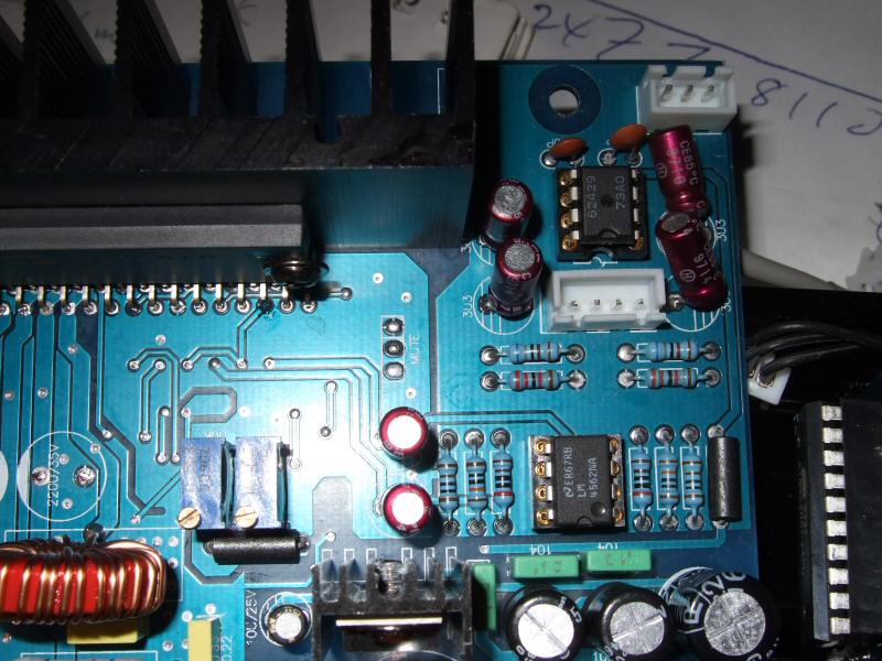

I am surprise no one mention this amp yet, guess I'll be the 1st to start this.
This is a I suspect this amp should became fairly popular as it is one of the few T-amp with Remote volume control.
It uses a TA2022 with around +/- 35v, a LM4562 for buffer/gain (~3x) stage, and an electronic volume chip "M62429" will some additional circuit for remote control.
I was attracted to it be the remote control and the use of the LM4562 (because it is currently my favorite opamp) which shows the design must know a thing or two about good sound. Oh, and the good price helps (sorry, google this yourself).
The amp sounds surprisingly good despite the signal path going thur 3 e-cap (Elna audio bi-polar). And already better than the 41hz amp3/6 I had use before (mostly likely because my speaker requires a bit of current to drive).
I initially thought that the electronic volume was the CS3310, but no, it was a little known chip "M62429". But I believe that this is also a very good sounding chip.
I had already did some mod to this amp. Will post later on this.
Here is an internal pic.

Please check your amp's fuse as mine has a 1A fuse, it should be around 4~5A.
There is a lot tweaking you can do if can solder. Replacing the 3 coupling e-caps will be an improvement.

The biggest bottleneck for the poppulse is the 6 coupling e-caps. Replace those and you'll be on another level. I suggest Visay MKT1822 3.3uf (63v or 100v) will be an excellent choice.
Check the fuse, if it is 1A, replace it with 4~5A.
The decoupling for the poppulse is not the best. And for the life of me, I don't know why there are no regulation of the +/- 35v and that the e-cap is removed just next to the chip. There are only an Elna 4700uf + 1 smd all the way to the ta2022.
So add a nice > 200uF/35V cap back into that empty cap space next to the chip.

ChuckT said:
The 6 coupling caps are red Elna BP 10uf/16v in the pic.
Thanks chuck for the pic. Much appreciated. This will help.

Yes, MKT1822 under the ERO brand before Vishay buy them out.
Mine are green with the Vishay label, I don't know if they will be a difference in sound for the old and new.
I got them from Farnell too, so I think you'll get the green one too.
BTW, if u don't need a lot of gain, it may be possible to bypass the opamp and connect directly the M62429 output to the TA2022 input cap. I think inside the M62429 has opamp out already.
If u don't know what I am talking about, just ignore this.
Also order a couple of Rubycon ZL 470uf/35V to put into the empty 220uf/35V cap space next to the ta2022.
