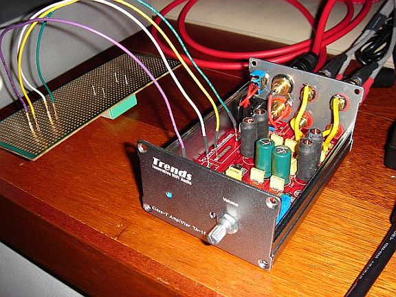

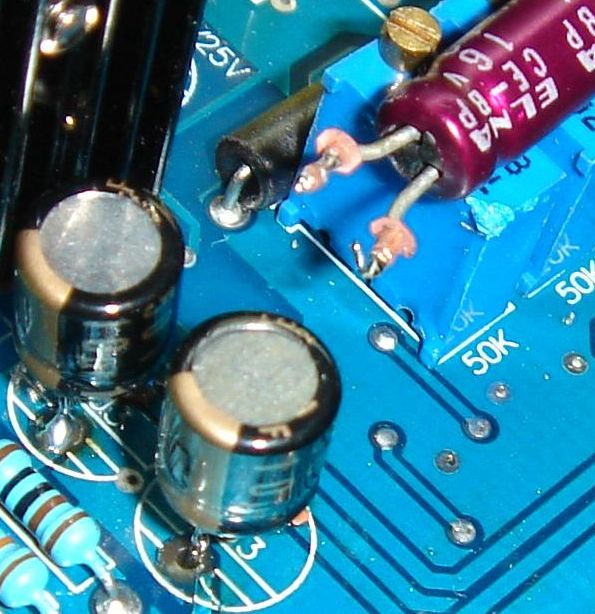

Hahahaha just completed my first mod job. And looks like I may have to use the MKT afterall. Here's the story:
Turns out I didn't have to order the BlackGate. They were available here in KL for about USD 1.50 a piece. Sonic Craft price is USD 0.95 a piece but add shipping n handling it came to USD 48 or so. So USD 9 and no wait, went and got it today and came home to do the mod.
Removing the old caps seemed easy enuf. But on the last one was abit tough but came off nevertheless. It looked like I lifted the solder pads on the top part of the PCB. (Damn.) Anyway, proceeded to solder the new caps and put everything back together and test. Hmm right side music, left side nothing.
Now I am surfing to see how to repair the solder pad joint or find where to patch the broken circuit.
Other choice is to figure out the circuit for the 6 e-caps and do some patch wiring.
Sigh. Since it would involve major patching on the board, might as well try out the MKT once I'm done with the BG.
The Tweak Kit from Audiomagus will be coming next week. And I been busy looking at the Trends Mod threads on whether to use the Auricap or other film cap. Ebay has some WIMA MKP that looks interesting. I am already deviating from the standard kit by using the Nichicon cap instead of the Panny FM for the power supply. I think I will use the Nichicon cuz the cap is 10 mm dia. which is the designed size. The Pannies are 12.5 mm dia.
Actually, by next week I should have everything in to do a makeover. I have the case from Italy, an Alps Blue, Panny EJV, a HK stepped Alps (from a pre-amp kit.) Aah, I don't have a knob yet.
Anyway, I still pondering whether to do the makeover with the Trends or the Poppulse.

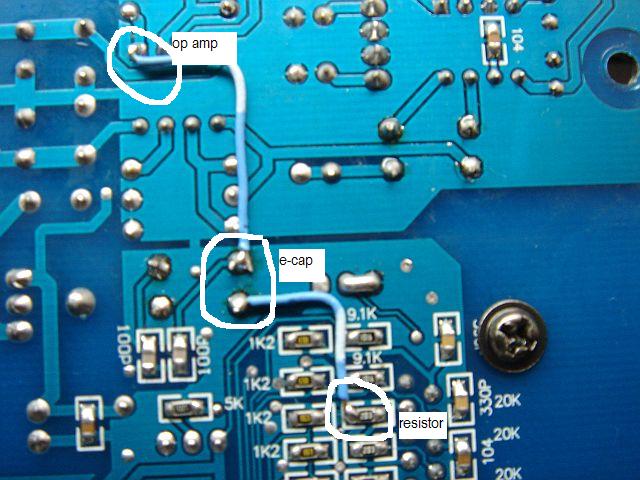

Sorry for the delay ChuckT, had to bring back the camera from the office. Dunno where my dotter put hers.
Here's a pix of the damage. The cap next to it looks good though (me thinks.)
Here's another perspective. This pix has the original elna cap on the trimpot showing the solder pad, err copper substrate? Still attached to its legs.. ouch!
I got some ideas from http://home.comcast.net/~machrone/bjr/mistakes.htm which will require some mod job on the copper trace and make do a 'solder pad' out of leftover legs from the BG caps.
Or I think I can jump the circuit via soldering wires directly to the legs at one to the resistor (I think) but on the other leg, the circuit goes to the op amp but err I don't know which leg of the op amp. Either pin 1 or pin 7 (output A and output B resp. according to the datasheet.) I presume output A & B refers to left and right channel. I need to disassemble the board again and look at the underside trace.
What's your thoughts?

Tsk tsk, that is why I said practice on a throw-away PCB first.
Looks like you have not completely melt the solder before pulling on cap. You should not use force while pull out the cap.
Yes, the output can be tap from one of the resistor that you can directly solder on. Use a meter to check the ends of resistor to the cap hole.
And why are u putting in another e-cap in place of the Elna, no difference!?
That is not a Blackgate non-polar.
No need to put 2 1uf together, just use one 2.2uf, or use 3.3uf if there are space, not much bigger.

Hehehe did practiced like you said. On 2 old PCBs. I think the old PCBs better quality boards. The ones on the Poppulse (pic) I wreck was the last e-cap to be pulled out. No much force used. It actually came off easily once the solder melted. I think my mistake was to de-from the other side. I should have melted the solder on the trace side then pull.
Ok so you suggesting I do the jump cable method and connect the circuit from the resistor to output leg of the BG. That one was quite easy to figure out. What about the other leg which has its solder pads pulled? The trace leads back to the op-amp. Do you have any idea which legs of the op-amp I would connect to?
With regards to the BG e-cap, you mean I should have used the C-series BG? I'm kinda new on this.
As for the putting 2x1.0 uf together, it is because there is no stock of the 2.2uf 250v in Farnells. The 2.2uf that was available was in 100v. Next up was the 1.0uf in 400v. So as not to waste time I got both and asked you which of the option is better to replace the stock 2.2uf 250v cap on the Trends.
There is another reason I recommend to use extension wires, you can easily change the cap if u don't like it, and u can use a bigger caps.
I think your damage trace is one end from the opamp and the other to the ta2022. If u tap the resistor, that is from the opamp. The trace to the ta2022 is much more difficult. Guess you'll need to do that scrap and expose copper trace to solder trick. Use an extension wire for that so that you can easily replace cap.
I like mkt1822 more then BG.
For BG, do not use the C series, use the red N grade.
The 2.2uf/100V is fine. No need to match V here as only use for coupling purpose. Or u can get the mkt1820 3.3uf.

Actually to the op-amp its directly to the pin 1, and to the ta2022 its to a resistor on the underside. (See pic.) I used old cat5e cables for the jump.
Phew, the jumps worked and I have stereo again. Now testing with the small speakers. Tomorrow I shall listen through the floorstanders to check out the bass. Otherwise, now it sounds good from the small speakers.

Hey, good job.
