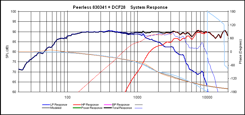

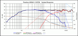

Fun With PCD
Alright, here's the result of tonights fiddling w/PCD (note the phase alignment!):

Re: Two things
Critofur,
Two things:
1. You need to extract the minimum phase of the .FRD and .ZMA files for the drivers you are using. There are some tools at the FRD Consortium that can do this, as well as Jeff Bagby's response modeler. Until you do this, you cannot accurately model a crossover. That is why your phase looks so smooth... it's an estimation of the electrical phase inherent in the crossover design--but does not take into account the driver's phase.
When you trace the FR or Impedance curve of a driver, you don't have the phase--YET. You need to run the .FRD or .ZMA file through a minimum phase extractor: a very complex algorithm that figures out where the driver's phase is at each plot on the curve. You re-save the file, then bring that into your simulation software. YOu'll notice the driver's phase will be far more ragged; that's normal.
For instance, take a look at the Peerless version of the Aethers. These graphs were all traced from mfr's specs, then minimum phase extracted. Had I not extracted minimum phase, it would have all looked smooth--which is not accurate.
2. Your design does not take into account baffle step loss. That is, on a normal 6-8" wide baffle, you will lose approx 6 dB as the frequency gets into the low hundreds of Hz.
The only case this wouldn't be true is if this were an in-wall design. Otherwise, the speaker will sound very bass-shy. Try messing around with either Paul Verdone's Baffle Diffraction Simulator or (my personal favorite) Jeff Bagby's Response Modeler 2.0 to see what I mean.
You need to do this step (and the minimum phase extraction) before you take the files into PCD or any other XO design software.
Hope that helps.
-Paul

Undefinition said:
Critofur,
Two things:
Right after I posted that I was wondering why the phase wasn't included in the .FRD files you sent me and realized that was why it looked rediculously good in the picture I posted above... :bigeyes:
It's easy to miss some things when you're newly learning speaker CAD tools at 2 AM...
That "design" is only 2 way, I was thinking of using the 8" woofer (which is not taken into acount there yet) for part of the BSC, and, haven't built/modeled a dipole yet - was thinking there'll be some difference in the BS w/a DP...
Also, running the midwoofers in parallel (w/ ~ 2.5 xover) instead of in series will give plenty of extra output for BSC - just have to see if I have an amp that doesn't mind impedences that low...
The main point was to see how the DC28F would matchup, which, of course, won't be complete until phase is added into the equation...
With the "Walsh" style designs I was working on earlier, BSC isn't really an issue, though, there are other issues unique to them.
Where is the BSC in your PCD model of the Peerless Aethers version posted above? 😕

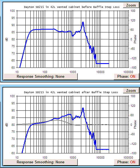

When I was first designing the Aethers, I was told by very reputable sources that dipole roll-off would be an issue around 150-200 Hz. I tested the dipole section of the Aethers on its own, and I found that what they told me was dead-on.
I took this into consideration when choosing a crossover point between the woofer and mids.
The Baffle Step is compensated for in the design. As you can see, the system has a sensitivity around 85 dB. The Dayton SD215 has an 89 dB sensitivity--however you must keep in mind that when they take those measurements, that's on a flat (sometimes infinite) baffle. Once you put that woofer in a cabinet of normal width, you lose 4-6 dB, depending on how far you are from the wall.
So, using simple math, I have about 4 dB of BSC in that version of the Aethers, same as the first version. They're really made for music, not special effects. With the 3rd version (the TB version), I put in a bit more BSC, so I'd estimate the sensitivity of that system to be 83-84 dB. That time, I thought I'd shoot for something that was just rock-solid all the way down into the 20 Hz range, and I think they hit that mark.
In other words, the COMPENSATION for Baffle Step loss is to attenuate frequencies above 200 Hz to bring them down to the now-reduced level of the woofer. There are many ways to contour the upper frequencies so that everything comes out flat to match the volumes the lowest frequencies of the woofer.
