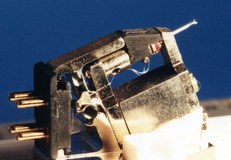

Here's a (rather poor) photograph of a naked Ortofon Quattro. I thought it sounded super, but when I first took the body off, it was rather sibilant. I decided that this was probably because the magnet was resonating on its mount, so I wedged a small piece of balsa wood between the magnet and the cartridge top plate. The sibilance disappeared.

The Ortofon exercise is useful...have you still got it? If so try try glue trick...they are better cartridges in so far as there is a bolt holding it together. Fill the gap between the magnet and the tube as far as you can without risking damage to the coils.
