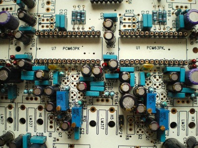

The board is very densely packed in places, and is a bit daunting when you come to locate the correct location for many of the resistors and caps. I've had to resort on a number of occasions to searching the schematic pdf to locate the context of a part number before I could find it's position on the board. :xeye:
I've managed a few soldering sessions and have roughly got to midway through step 3 in Spencer's suggested build sequence - surface mount regulators, resistors, diodes, jumper pins, and ic sockets, plus 75% of the 0.1uf film caps are mounted on the board. I've also soldered a surface mount cs8412 onto one of Spencer's 8414 adapter boards.

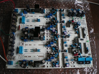

Board overview
Board stuffed to analog power supply testing stage.

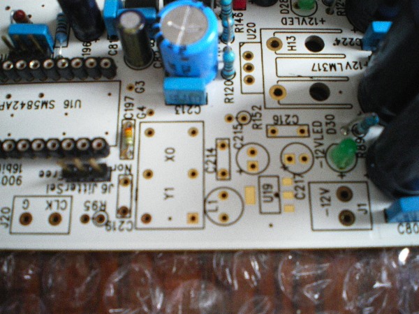

The pics are a bit low res I guess... the pads are definitely gold plated, and the "bling" white solder masking is very thin and scratches off pretty easily to show gold underneath. Personally I'd have preferred blue or green solder mask and tinned pads.
Attached is a pic of the unused xo clock section showing some pcb bling. When compared to the D1 or Tent Labs dac clocks the xo clock section on the board seems to be missing some essential circuitry to allow the xo clock timing to be adjusted vs the recovered clock. This lack apparently results in clicking on the output when using xo clock. I'm not sure how feasible it will be to implement a piggyback board to get the xo clock working correctly.

thinking about the xo clock in the shower, it occurred to me that the main issue is tapping the clock signal across to the xo pinout. I guess I'd need to use mini-coax for the jumper to maintain signal integrity?

The parts count is quite high, and the JFET I/V sections are very densely packed, which looks quite daunting, and the parts identifiers can be a bit hard to find on the silk screening. Some part numbers are illegible and you need to resort to the pdf of the silkscreen to confirm what the actually number is.
The build instructions seem to be based on Spencer's personal build notes and there are a few steps that I'd do in a different sequence and other small things that he doesn't mention. For instance I discovered that the transistors for the mute relays aren't shown in his pics, nor mentioned in the notes but the outputs are muted unless they are installed.
Parts quality is variable: the many of 0.1uF film caps had rusty leads and required a careful clean before soldering. Some values of panasonic fc had pre-cut leads and I had to hold these caps in position while I tacked one lead into place.
But I think if you are comfortable with soldering a densely packed board, and reading the schematics to confirm parts locations and values, then the assembly becomes simply a matter of being methodical and careful in component placement.

I haven't tried to use the XO section that's on the board. I don't actually think it can work without clicking as the clicking is caused by drift between the XO and the recovered clock. The advantage of the VCXO is that it can be adjusted to keep the two clocks locked to the same frequency. When I get some time I'll take a look at making up a daughter board with a VCXO similar to the original D1. I believe this is the only way to solve the clicking problem Spencer described in his thread.
The daughter card really only needs a handful of additional components to adjust the VCXO frequency to match the recovered clock. There is a dedicated 5V psu for the XO on the main which can be tapped for the daughterboard. Spencer has suggested that the DIR9001 is a better low jitter alternative, but I believe jitter can be further reduced by an order of magnitude by implementing the VCXO. The minicoax was a thought I had for jumpering the recovered clock across to the daughter board as cleanly as possible.
