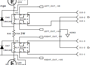

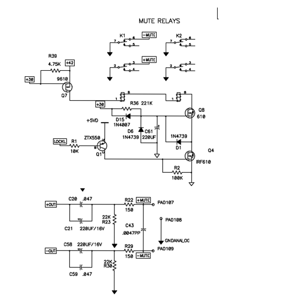

Another D1V3 "tweak": Output Relays
Checking Spencer's schematics vs the D1 service manual I've discovered the D1V3 mute relays have contacts in the signal path :down: , rather than the ground shunt used in the D1 :up: Should be easy to work around, as my old DAC 2.0 had the same type of bypass surgery done on it. Looks like a job for the post holiday tweak session.
Update: Ironically the assembly instructions direct you to cut the pins required to implement the fix off the relays!! If the pins are left on and soldered to the pads - which are grounded, it's a simple matter of cutting the traces between R19,20,30,40 and the relays, then running short jumper wires from the relay side of R19,20,30,40 to the output pads. In normal operation the relay is not connected, but in mute mode the outputs are shunted to ground.

rewire
Ran out of time to edit the post. I've attached a pic of what needs to be done.
Cut traces on the X. The relay pins that need to be soldered are in the red circles, and the green lines show where the jumpers need to go.
If the pins are already cut on the relay you will need to replace the relays to perform this mod.

Disabled Account
Joined 2005
Hi Spencer,
The instructions you refer to in the assembly manual leaves relay contacts in the signal path. Which is precisely what you don't want if you are concerned with good sound, and what the original schematic avoids by using a shunt arrangement.
The description in the assembly instructions show the two pins being taped to AVOID being grounded. I'm saying these pins NEED to be grounded, to allow the output to be shunted to ground. The output from the resistors R19,20,30,40 should be wired directly to the outputs, and the traces connecting R19,20,30,40 them to the relay should be cut. In this arrangement there is always a direct connection to the output jacks with no contacts in the signal path. The output is shunted to ground when the mute engages.

Disabled Account
Joined 2005
Relay Mod
Output relay mod is done. Apart from a minor "foxes paw"* of connecting + of right channel to gnd and wondering why I had a what sounded like a major ground loop the procedure was straight forward and as described.
It is easiest to jumper from relay side of the output resistors to the output connector pads. I also changed the digital rectifiers to 8TQ100 schottky so not sure what mod contributed what. There seems to be a minor improvement to the precision of imaging, which is similar to the results I got performing the same mod on the DAC2.0. The improvement isn't earth shattering, but still worthwhile I think.
