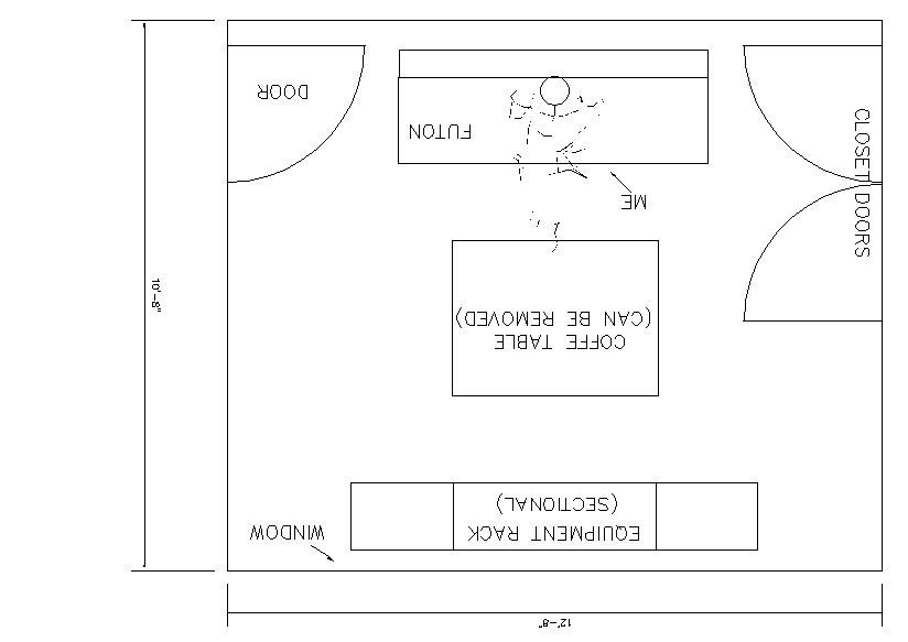

There are to many designs out there and my head is starting to hurt. I need help deciding what to build.
I've attached a rough layout of the listening room. It's 12'-8" x 10'-8" x 8'. The amp is a Jolida 202a (Gonna try wiring it triode.)
I really want to fit a Half-Chang in there. A B20 would fit my budget alot better than an un-modified fostex right now but I could stretch it if arguments convince me to go that way. I can mod them later as my skills improve.
Music runs the gamit from Vivaldi to The White Stripes with long stops in Alt. Surf rock and Post Rock Instrumental. (Who comes up with these genres?) With some Jazz and old country(Think Marty Robins ect.)thrown in to taste.
Designs considered so far, Half-Chang, Zilla's 3 cu. ft. B20's, Demitri, Melvina, Brynn, Floorstanding Fonkens(maybe even the PAWO style fonken), PAWO, Harderrors FE-126 Horn, and the Frugalhorn.
Any and all comments are appreciated. Plus if there are any designs I haven't listed that would be good canidates, let me know.

Well, given that your taste appears to primarily reside amongst the heavier side of things, and the room is a reasonable size, I'd be inclined to go with the 8in drivers. They sacrifice a bit of midrange magic to give better LF, so should be a good compromise. The B20 is a fine unit for the money by all accounts, & you can always upgrade to the FE207E when funds permit, so of the speakers you list, my choice would be Half Chang with the B20 & a pair of tweeters crossed in at ~5KHz.
Dimitri would be my next choice of those you list, with the 8in units. Won't sound as big in the LF, but certainly not small. You'd need to go straight to the more expensive units like the 207 or FR8c if you went for this approach though.
If you wanted smaller, the Frugel-horn or Ron's A126 would be my choice of the designs you list. Midrange will be to die for & they certainly go plenty low, but I'd want them supported with dedicated woofers. Small drivers have their limits -you can go loud, you can go low, but they can't shift a large quantity of air as well as dedicated bass units. There's no substitute for diaphram area in this respect -LF transient handling in particular will always be weaker with the smaller drivers (love them though I do).
Basic test I've recently developed. To know if a speaker will do well on rock, play Phil Collins's 'I Don't Care Anymore.' Drums should a) sound HUGE, b) be quicksilver-fast, and c) you should feel the weight of air smack into your chest. One or all of these missing? Not a good rock speaker.

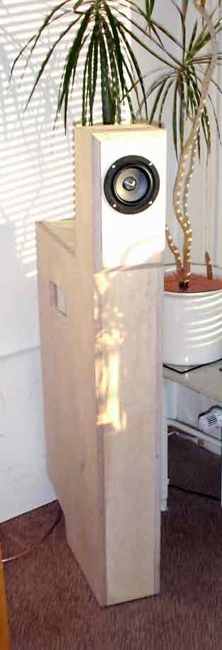

Cornet - THE Speaker alternative with only 17 cm width, for 10-13 cm driver, here:
Front driver Tang Band W4 1320 SD, rear inversely polarized the Monacor SPH-60 X 8 ohms,
It should hundrets different chassis combinations are possible,
Driver Reso 40-120 Hz, stroke min. 1 mm, Qts ~ 0,2-0,6
written under plan.

Begging your pardon Scott, but all things considered, I'd tend to suggest maximum 6" driver for a room this size.
I think you can count on enough room gain that any of the full sized Scottmoose or BIB designs for 8" drivers would easily overpower the room, and if placed near the corners, might well have trouble integrating a seamless soundstage at the listening position shown on your sketch.
I recently built a pair of Brynns with FE127E for my sister, who is using them in a much larger room than you show (15'wide x 20'long, 15' cathedral ceiling, and extending into an attached kitchen/eating area) . She's only 2yrs younger than myself, so her headbanging days are past, and she hasn't yet complained about them not being big enough.
The Denon receiver she's driving them with however isn't as satisfying as the Kingrex T20U with which I first demo'ed them.

You must be from England or something. I'd put 10x12 into the smallish category,
Yep, we decadent Britishers again. An Englishman's hovel is his castle. 😀
Re the driver size question, fair point -the 6 1/2in & smaller units will be easier to get singing right in a space that size. Still, 8in isn't impossible. Too much power? Damp 'er down or bleed off some pressure. I've had Ed's Vofos running in my room (roughly the same size), unmodified, no probs. Though my 167 MLTLs admittedly sound a little sweeter, if not quite as dynamic, so YMMV as always. 😉
