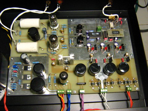

I want to make a good NOS dac based on AD1865 fed by a CS8414. I do not know what PSU would be the best for it. I'm thinking about shunt regulators based on LM431s, mainly for the analog supply.
Do you have experience with different regulator/psu circuits ?
The filter at the output is temporary, a transformer will follow the DAC chip than a 6072 fed with a 6X4.

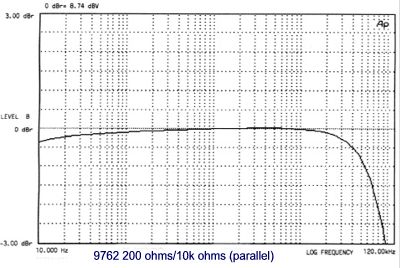

kevinkr said:That 270 ohm resistor should be more like 10 - 20 ohms, check the specification for the 1865 to see how much voltage can be tolerated on the outputs before performance starts to degrade.
Kevin, my experience with the 1865 is that up to about 200R is good for the I/V. Sowter even recommends this value when using their I/V transformer: http://www.sowter.co.uk/specs/9762.htm
Things like the 1541, on the other hand, don't like higher than about 33R.

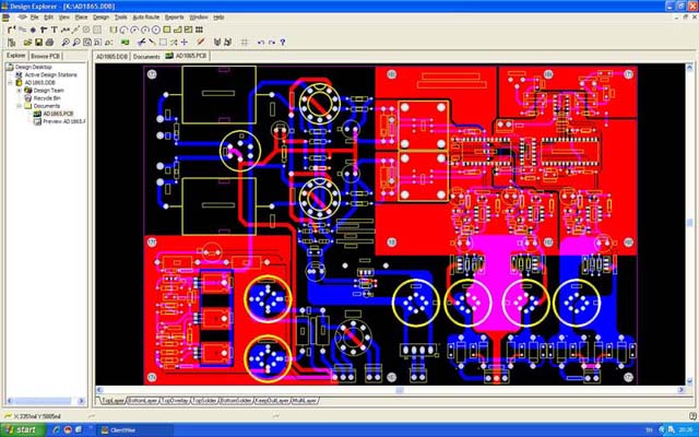

One more important question I would have :
On all the drawing I have seen so far, the "analog" supply of the 8414 is supplied from the digital supply, but the analog ground of the 8414 with the filter is connected to the analog ground.
Is this normal ?
I do not feel good about it, since it makes current from the digital psu through the anlog ground, analog-digital connection and than digital ground (or the way back with the phisical current flow).
A less important thing, I see a suggested reset circuit in the datasheet of the 8414, but nowhere implemented, as well as some D/A converter requires that at powerup, the analog supply comes up first, this is not guaranteed anywhere either - in the other hand I thrust it is not necessary. The first thing makes me more nervous.

Extreme_Boky, thanks for your reply. I can not find the sds lab article. Google did not give a site for that expression, if I take out the 4329, there are sites found, but I can just find the headphone amp article and a lot of discussion, evaluation modification of the dac, but not the dac itself.
In the other hand, I made CS4390 based dac, I had no problem with grounding. Also I got some good material pointed about it, but I questionned the AN dac drawing.
Do you think that what I did at the ground is wrong, or not good ?
I do not like solid ground plane at audio (based band) circuit. At pre amplifier and solid state amplifier it was better without.
Or you mean the connection of the 2 gnd must be at the PSU instead of under the dac ?
I think on this single mixed signal IC layout, it is the best to separate analog and digital circuitry, but not separate analog and digital ground.
I have seen dsavitsk's site before, I have seen the grounding and I agree with that, except I do not like the ground plane under analog circuit.
