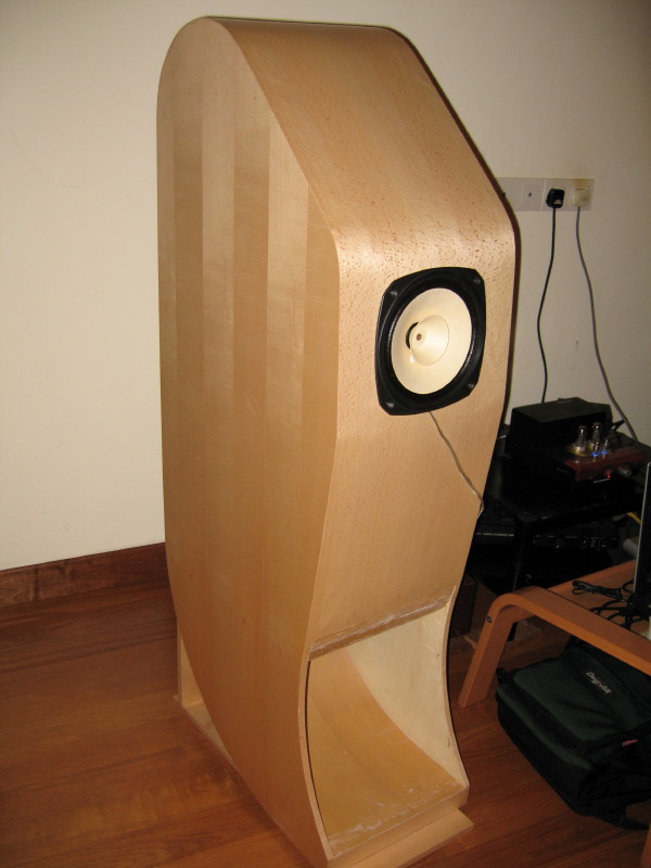

Just want to share my DIY Horn speakers based on the Dallas III and Fostex FE206E. You can read it here. Tell me what you think....
Jason😀

Hi Ronc,
Thanks for the design. The speakers are really good and as long as I am off axis with the speakers toed out, I don't notice the shout inherent in these speakers.

is the thickness of the side walls enough ??
Based on the spacing of the internal supports, yes. However more bracing would be better.( Texas sayin " if more is better then too much is enough)
I ran the side loading sims on a structural loading program that was modified from a building enclosure program
that was altered for internal pressure fluctuations. (blow into a square box and measure the deflection of the sides)

I just noticed in your pics the wires hanging out from the driver flange.
ANY leaks in the flange to baffle surface will affect LF performance. The driver flange should be totally sealed with something on the order of silicone sealant.

2. The speakers are all sealed up so there is no way for me to add additional support/bracing unless I cut it open.
3. Yes the pictures do show that the wires are stickin' out and there is no proper seal. That said I very satisfied with Well, I have not installed the binding posts and I have also been asked to try the Coral 8A-40 in these cabinets. Once I have done all this, I shall seal up the cabinets.
4. I guessed that Ron did not design the Dallas III, but after cross referencing the measurements with the Dallas II, all measurements seem to line up. What I am not sure about is if the radiused corners will change the parameters and this the sound all that much....

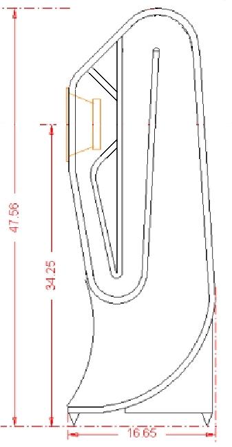

The Dallas III is indeed a beautiful design. I am not so hot for the Dallas and Dallas II though. Here is the side profile fo the Dallas III showing the internal structure...

Dallas II
And here is the Dallas II for comparison. For ease of build, the Dallas II wins hands down. But for both functionality and good looks... choose the Dallas III.

and the Dallas III... much more attractive, but does the radiused corners affect the parameters and so the sound.... negatively?
Nope! just a gain in efficency because there is less turbulance in the wavefront as it traveles. Down side is a slight increase in mids coming thru the mouth. However the actual horn action begins a slow roll off at 247 hz and ends at around 400 hz. From there the baffle action takes over (overlaps with the horn roll off) and as the frequency increases finally hands off to the driver. The absolute lowest frequencies are a TL action which blend into the lowest horn action at around 120 hz. The higher frequency TL ripples are then blended with the horn action. This results in a smoother mid bass.
