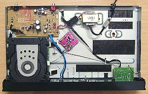

I would think the red PCB is a new clock? , btw what dac does that player use?...
I think Analog Devices not "the analog devices" but a german diyfirm sells a Pcb with some crystal chips for uppgrading the philips 7xx and marantz 4-5000 maybe worth checking out?
I dont find any web reference for them but it was an article in Klang und Ton not so long ago.

hifi said:I would think the red PCB is a new clock? , btw what dac does that player use?...
/micke
Maybe the red pcb it's a new clock.... it look like and the position also... close to the servo board.
That article may be useful. Try to find it out.
The DAC is a TDA 1545A with Iout

Massimo:
Thanks for the info ... makes sense. I'll probably leave the mod as it is as I don't use the digi out.
The weird thing is ... it did make the player sound better thru the analog out. I'm using a LM6172 opamp & it sounded very aggressive. The changes to the transport pcb (tho wrong) did tame the harshness. A few other people also noticed the same thing.
The red pcb is a clock mod. Beside mods found at Decibel Dungeon ... I also changed numerous passive parts with good results.
*Better caps with higher capacitance
*Audio grade resistors in the signal chain.
The DAC is a TDA1545.
