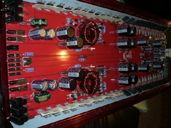

This amp is kicking my butt. When I got the amp I replaced a bank of NDP7060's only 4 of them were bad but I replaced all 6. Also replaced the TL494CN, It looked like it had been hot along with 2- 47uf 25volt and 1- 1uf 50volt caps next to the TL494CN. I then installed 1- 5 amp fuse on the left channel and one on the right channel. Powered it up and was getting loud humming on both channels, like when the RCA's aren't grounded. Music wasn't loud either. Then the fuse went. checked all the NDP7060's and found one bad that I installed. Replaced it. Replaced fuse and powered on again. Then 2- 2N5639's OP amp's popped. So I then noticed that when handleing the cicuit board I had smashed some other op amps over and they were shorting on some nearby resistor's in the preamp section. Which is why I was getting the humming noise in the speakers. So I made repairs and replaced the 2- 2N5639's and powered up again. No humming this time but only stayed on for 10 seconds and blew the right channel fuse. This amp has 3 - 30 amp fuse's per channel. 180amps total, So I tried a 10amp on right channel and it stayed on alittle longer but the speaker made like a melting noise before it blew the R. channel fuse again. I don't know where to go from here. PLEASE HELP ME...:bawling: :bawling:

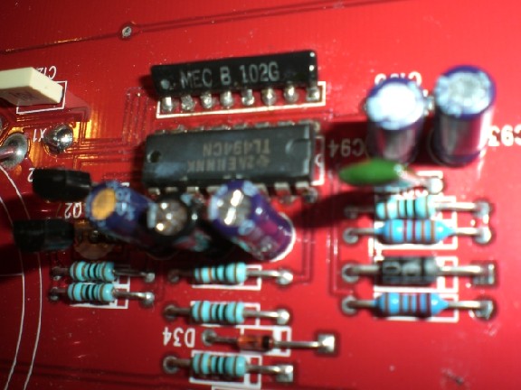

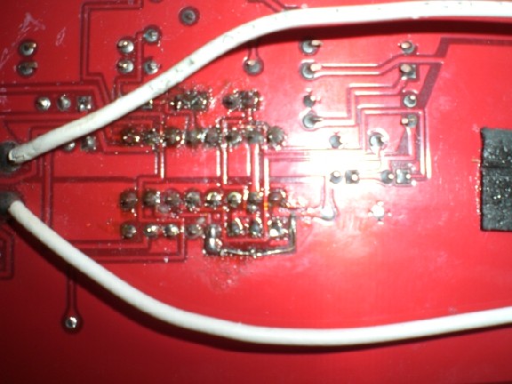

Also in the pic above with the TL494 the multi resistor I accidently removed thinking it was one side of the TL494 and it got pretty hot, Would that hurt it? Also on the bottom of that resistor somebody ran a jumper from one leg to another. I don't think this amp had ever been opened before so maybe it was a design flaw and the factory jumpered it? Here is a picture of the bottom.

Also it was the left channel that I had to replace the NDP7060's in. The right channel fet's were fine. But for some reason it is the right channel blowing fuses now. Fet's are ok.

I haven't tested yet, just after reading your responses I went and checked my 8 ohm bookshelf speaker I use to test my amps with and now it is a 0.1 ohm speaker.🙁
So apparently I am getting alot of voltage through my speaker outputs.
I will test like you said, But what if it keeps blowing the fuse before I can test? Is there any testing I can do without powering up first? thanks.

In your second picture it almost looks like one of the legs on the bottom row (5th) seems to have a spot where its actually connected to the large trace at the bottom area. Look at the small silver jumper about in the middle, almost looks like a small spot where it bonded to the lower area. Are they supposed to be seperate?
sorry for my crappy edit skills:😱

Ok.. I have 29.7 volts DC on both left and right channels. I didn't have good connection to other speaker apparently and that is why it didn't blow fuse on that channel.
And yes, the speaker was good. Heard it play hour before testing.
So what should I do now??? Also nothing got hot.
PPIa600: No that was a repair trace ontop of old trace, after looking at it closer. Thanks anyway.

Ok on the output's- there is 6- 2SD1047E's per channel that I am getting 43 volts on outside legs & -16 volts on middle leg from B+ terminal the other 6-2SB817E's in the channel I am getting -16.5 on left & middle legs & -17.4 on the right leg.
OP amps:
OPA134PA's - V- = -13.63 & V+ = 12.94
LF444CN & LM837N I got the same voltages as above.
And yes the middle legs are 0 ohm's on the output's
