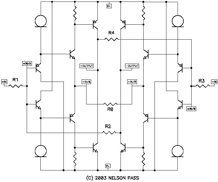

Herewith I would like to present a method of doing this with a pair of op amps (or a dual op amp if you like) of the "current feedback" variety. As you may know, current feedback op amps look like regular op amps except that the (-) input pin is low impedance. They are distinguished by exceptionally wide bandwidth and stable operation, mostly because the feedback network also functions as gain degeneration for the input stage.
Below you (hopefully) see a diagram showing two such op amps interconnected. Each consists of a complementary pair of input followers (actually just buffers, and not conceptually significant) forming the (+) input which drive the actual complementary input devices, where the Emitters form the (-) input to the op amp. These devices in turn drive a pair of complementary output devices whose collectors form the output.
Each of these op amps is a slightly simplified version of commercially available parts. Just go to National Semiconductor's web site and look for "current feedback" op amps.
What will be unusual here is that we have joined the (-) inputs of the two op amps to form the SuperSymmetric connection between them. Each of the non-inverting (+) inputs operates at virtual ground by virtue of the feedback from the output of the opposite amplifier. This effectively makes the (+) inputs of the op amps behave as if they were (-) and vice versa.
R1 = R3, R2 = R4, and the gain is set by R2/R1. The input impedance is R1 if driven from a single-ended source, or 2*R1 from a balanced source. Any undriven inputs should be grounded.
R0 sets the open loop gain of the system, and can be adjusted upward for greater stability, or downward for more feedback. This is a good place for a potentiometer for those who like to explore these issues.
The output, of course, is balanced, and best performance is obtained by using it balanced. The input can be operated balanced or not, but gives slightly better performance when driven by a balanced source.
I haven't yet run across an example of a monolithic higher power op amp using current feedback on the market, but there is no reason that one would not exist. If you find one, it will probably make a dandy SuperSymmetric power amplifier, but until then we have to content ourselves with low power.
Or build something discretely......

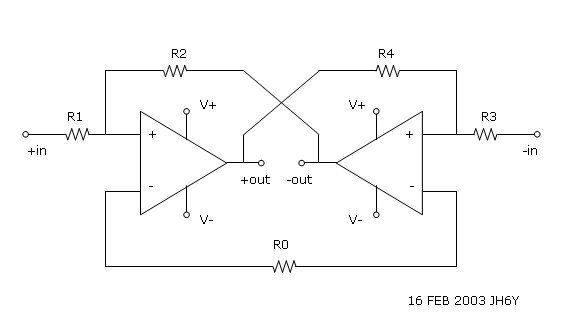

jh6you said:This way if I redraw using op-amps...?
Not quite. Your feedback resistors need to be cross connected. R2 to -OUT and R4 to +OUT.

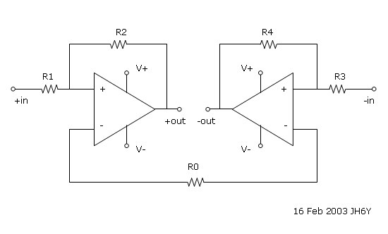

jh6you said:It was a mistake. Here it is.
There ya go. And if you want to really get technical, you can draw the opamps with current source symbols between the inputs (to indicate a current mode amplifier as opposed to a voltage mode amplifier) and make the power supply single-ended. 🙂

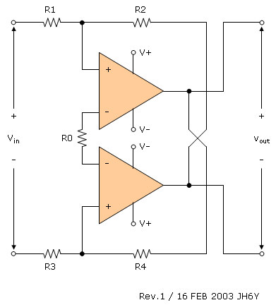

I have just thought about only the concept what Nelson Pass explains. Accordingly, the drawing is a conceptual sketch. Is the following new conceptual sketch better? As a professional technician, could you kindly recommend the resistor values for the practical approach? Thanks.

jh6you said:I have just thought about only the concept what Nelson Pass explains. Accordingly, the drawing is a conceptual sketch. Is the following new conceptual sketch better? As a professional technician, could you kindly recommend the resistor values for the practical approach? Thanks.
It's certainly a much more elegant drawing.
As for resistor values, the ideal feedback resistor (R2 and R4 in your drawing) value is rather device dependent and should be determined by the information given in the datasheet of the particular device in question. There's a whole interrelationship between feedback resistor, power supply voltage, load impedance, and closed loop gain that make designing with these kinds of opamps a bit more complicated than your basic voltage feedback opamp.
So I guess the first order of business would be to pick a readily available device to start with.
