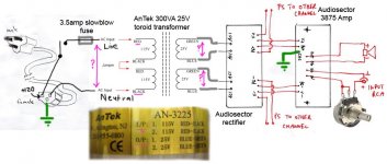

Sanity check
I am preparing to power on the amp for the first time ( :D ) and I would appreciate some experienced eyes looking over the layout.
I have read much about hookups throughout the forums but I still unsure about the Antek transformer wiring. Below is a pic hobbled together from other DIYaudio posts. Is this hookup correct? I have drawn pink arrows where there could be a switchup...
For starters you first want to run the PSU on its own, and measure the voltages it is putting out, to eliminate PSU problems destroying your amp... (speakers)
Once this is done and it looks ok, connect it to the amp boards...
Short the input and measure DC level between amp output and ground... this should be very low, a few mV or so... now connect and old speaker and make sure it plays fine at low volume for a while without seriously getting hot etc...
Regarding the pot....
WAY WRONG WAY TO GO THERE....
input goes to pin at max volume side, output from pot goes to middle pin, 0 volume side pin connects to ground...
Re: Sanity check
remove the risk of damage due to a wiring error.
Use a mains light bulb tester for first power up of your transformer.
If all OK, then add the rectifier PCB. Power up again through the tester.
If all OK, add on one amplifier and power up again through the tester.
Get the idea?
