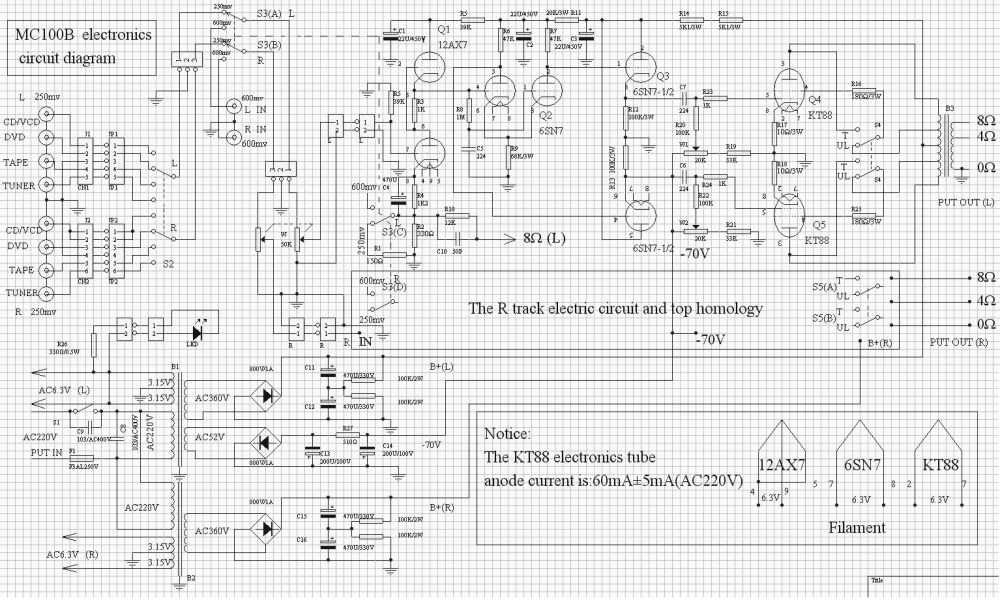

Hi there to all you experts out there. I have recently bought a Yaqin MC100b integrated amplifier from eBay. I have not hooked it up yet since I have read in quite a few forums that some of the bias from the factory were set wrong and the amp works for a few months and either blow resistors/caps or valves. I was wondering if any of you have had such experience from Yaqin amps and if any of you had owned or still owns the MC-100B and if you have a circuit diagram? 😀 As you can see from my introduction, I am a novice at valve stuff and would like to know how to "tune" the bias - either current or voltage to the valves. If any of you have some suggestions, I would very much appreciate it. Cheers.
Yaqin MC-100B circuit diagram
You might find this useful.
I have one of these amps, a most excellent sound.
Using one in the UK means I need to step down the mains 240volt supply or the heaters run at 7.4v and every thing is a bit stressed. I use a buck transformer this works very well.

Hi Duncan, many thanks for the circuit diagram which tells me to adjust the bias to 60mA. I will go ahead and get a step down transformer so the elements don't get stressed and prematurely burn out. Cheers, Spencer

aristocrat said:Hi there to all you experts out there. I have recently bought a Yaqin MC100b integrated amplifier from eBay. I have not hooked it up yet since I have read in quite a few forums that some of the bias from the factory were set wrong and the amp works for a few months and either blow resistors/caps or valves. I was wondering if any of you have had such experience from Yaqin amps and if any of you had owned or still owns the MC-100B and if you have a circuit diagram? 😀 As you can see from my introduction, I am a novice at valve stuff and would like to know how to "tune" the bias - either current or voltage to the valves. If any of you have some suggestions, I would very much appreciate it. Cheers.
I sold several Yaqin MC100B. The bias was always set between 40 and 45 mA with the bias on 60mA the tubes will burned out after 500 hours. With the 40/45 mA bias they will last for more then 2000 hours. The sound is the same.

Regarding the Bias setup for the tubes, from what I can gather, the instruction manual says to setup the bias at 55-60mV, however other members have indicated setting it up at 40-45mA. Which one should I use? Are they the same? Just wondering is it a matter of switching the multimeter to DC current to read the current flow on the same test posts rather than measuring the DC voltage? or is it trickier than this? Cheers guys.
Good question,voltage and current are not the same thing. If I had a schematic I could figure out what the voltage across the resistor translated in terms of current draw. LETS SEE IF I CAN REMENBER OHMS LAW. ITS BEEN ABOUT 40 YEARS. R=E/I R=6X10-1/45X10-3= A CATHODE BIAS RESISTOR OF ABOUT 13OHMS APPROX but this doesn't help us because we have no schematic! Thats about as much help as I can give you. Perhaps someone else can take over from here
aristocrat said:Regarding the Bias setup for the tubes, from what I can gather, the instruction manual says to setup the bias at 55-60mV, however other members have indicated setting it up at 40-45mA. Which one should I use? Are they the same? Just wondering is it a matter of switching the multimeter to DC current to read the current flow on the same test posts rather than measuring the DC voltage? or is it trickier than this? Cheers guys.
The manual says 550mv-600mv with is a current of 55-60mA thrue a 10 Ohm resistor. You just measure the DC voltage on the testpoints and devide it with 10 and now you have the biascurrent.
40-45mA measures on the testpoinst 40-45 x 10 = 400-450mVDC.
This current has proven that the lifetime of the tubes will be about 2000 hours while 60mA current burned up the tubes in 500 hours. I have a lot of experience with the MC100B.
keithgreenhalgh said:Good question,voltage and current are not the same thing. If I had a schematic I could figure out what the voltage across the resistor translated in terms of current draw. LETS SEE IF I CAN REMENBER OHMS LAW. ITS BEEN ABOUT 40 YEARS. R=E/I R=6X10-1/45X10-3= A CATHODE BIAS RESISTOR OF ABOUT 13OHMS APPROX but this doesn't help us because we have no schematic! Thats about as much help as I can give you. Perhaps someone else can take over from here
U(Voltage in Volts)= I(current in Ampere) x R ( resistance in Ohm )
Schematic of the yaqin MC100b in Post#2
Thank you gentlemen for such great help. Now, all I need to do is measure the DCV across the test points to measure 0.4 - 0.45V should be fine then? How about the schematics saying an input voltage of AC220V, mine is AC240V since I live in Australia. I have lifted the lid up on the transformers, and they did have stickers saying its 240VAC windings. Should the voltage still be the same across the test points or would they vary due to the input voltage being different? Sorry about my ignorance here. I don't think that matters, but just thought I'd check with the experts here. Cheers, Spencer
