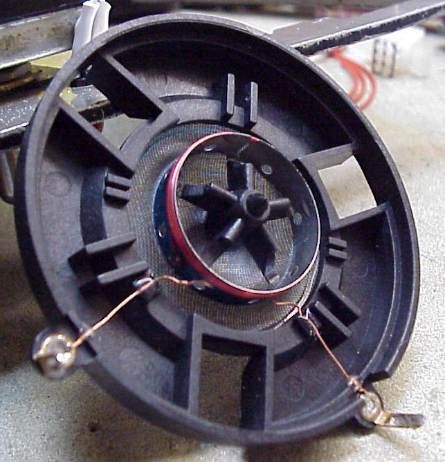

Did you slaughter this one or did you manage to put it back together? 🙂
I guess the star structure holds up the phase plug. What is it attached to? Obviously not the VC carrier, even if it looks that way on the pic. Does it ride on top of the pole piece? I thought the pole piece was vented to the rear chamber, though.
