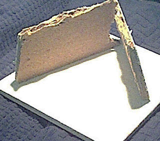

Therefor I use WEICHFASER softfibre the first m of the horn to reduce the "Schallschnellen" over 4/lamda of 100 Hz.
http://www.hm-moreart.de/11.htm in the middle
and look my horns.
One desisive point is for a horn you need min. 1 mm Xmax,
I write it several times. Therefor is a simulation with AJ horn
helpful.

Interesting material. Thanks for the heads-up Horst. I'm not sure how easy it is to obtain outside Germany -I've never seen it, but I'll now be looking. I don't like too much damping in cabinets -loads of damping is just a lash-up fix for sloppy design IMO, so this looks ideal.

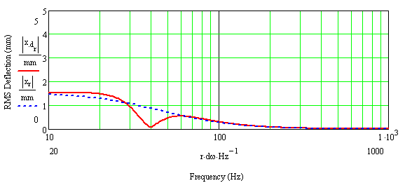

It's been a while since I looked at AJ Horn. Does the latest version now have facilities for simulating corner-loading, wavelaunch from the baffle, curved mouths and deflectors?
BTW -could you clearly set out your reasoning why a stroke 0.0394 inches is an decisive requirement of every driver in every cabinet? I've asked before, but you've simply pointed me to your Saxophon page, which frankly wasn't much use. I'm not trying to be unpleasent, just curious as to why you claim this figure to be universally applicable, and everything else is completely wrong.

the material is made of the rest of woodworking,
very cheap, a sound reducing board, may be you get
it not in 12-13 mm with paper, but because it´s made by
waste, it must got everywhere.
Ask you joiner.

Ah, now I see where the reasoning comes from. Fair enough for those boxes -it's not universally applicable though. Depends on the design and the room influence. I've done more sims than I care to remember in MathCad and not every box makes those demands. Here's a quick example I've got on the PC at the moment. 0.2mm 150Hz, 0.5mm 70Hz, total excursion (/2 for one way) at 1w input. It's for a BVR type of horn actually, so a long-path version with hyperbolic expansion should beat it.
To be honest, I reckon people get a bit hung up over Xmax sometimes. Best not to pass it if possible, I wholeheartedly agree -but so long as something really daft isn't being attempted, breaching it mildly isn't automatically going to ruin the sound. That depends on the distortion characteristics of the driver of course. Some are worse than others. The Fostex units are pretty forgiving in this respect.

Surely. The driver is the Eminence Beta12LTA 12in wide-band unit. The cabinet is a double-mouth (over-under layout) BVR style horn called Maria, that I'm working on with Dave at the moment, intended for for semi PA purposes. The plans aren't uploaded on the 'net yet, but it's about as simple as it gets, so shouldn't take too long. Great unit for the price actually. Not quite 'hifi' but a lot of drive-unit for the money.
The room has an influence on driver excursion if it forms part of the horn expansion (corner horns for example). So it needs to be taken into account if possible, or as close an approximation as can be done, as a 1/2 space or anechoic sim effectively is only simulating a part of the enclosure.

For the Eminence box, it rather depends on what you call 'very large'. ;) Actually, it's tall, but the rest isn't as big as you might think (as I say, keep in mind that this just happened to be a box I had to hand & it's partly intended for PA).
OK, what you need to simulate is a large BVR style enclosure 320mm wide and 362mm deep. The chamber is 1219mm tall. IIRC, AJ Horn isn't capable of simulating the two horn vents used, so sim them as a lumped parameter, throat CSA 147.2cm^2, length of 40cm, mouth CSA of 2438.4cm^3
Remember when simulating the Frugalhorn that anechoic or 1/2 space simulations are of only limited value, mainly for development purposes, because they don't account for one of the main parts of the enclosure and / or it's expansion (namely the room). Also, AFAIK, the only software that can model the wavefront pressure, expansion & thermal issues, and the effect of the curved mouth is Ron Clarke's.

I can't read your mind Horst (wouldn't life be easier if we all could? ;) ). Your statement read: "One desisive point is for a horn you need min. 1 mm Xmax, I write it several times." You didn't make any stipulation about driver size, and knowing that you regularly repeat the same thing (or similar) for drivers of 8in too, I assumed fairly naturally that you applied it to everything, and gave a quick example which, as I said, I simply happened to have to hand. I see now that you obviously don't apply 1mm stroke critera to every driver after all. However, this has gone far enough for the moment. We're mustn't hijack poor Dennis's thread in a discussion about Xmax, or about the design minuitae of the Frugalhorn.
