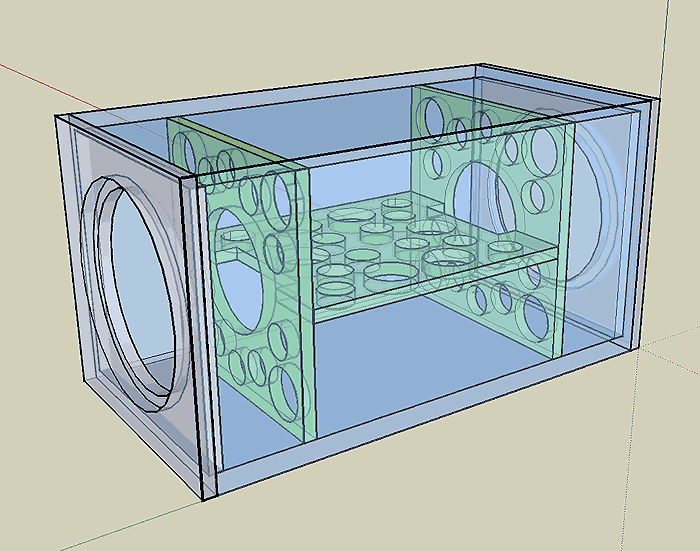

Just wondering if anyone knows if there is a limit to how close the magnets can be too each ohter, I'm hoping 20mm is Ok - any idea?
It will depend to an extent on how much power you're going to play through them and whather they have vented polepieces, As an idea, my drivers are rated for 1000W, and the sims indicate 40Hz at extremely high levels will be <100W/driver, heat won't be an issue. Run very hard, I'd put the driver motors on the outside for cooling.
You get most advantage of push-push if the magnets are tightly wedged against each other... this may pose an issue if your drivers have those pesky pole-piece vents.
Do make sure you get something between the magnets so they are tightly coupled.

Thanks Dave,
the drivers have vented pole pieces - can you suggest a suitable material to wedge - MDF Ok?

MDF is kinda squishy... a piece of hardwood is most practical.

This becomes a push-pull arranged as a push-push. A bit trickier getting the tight coupling , but a very valid approach if your woofers aren't all that linear.

I would not recommend using a wedge between the magents. It's important that the magnets are fitted tight together to get the full benefits of the design. It's a much better idea to drill or cut a suitable hole(s) in the dust cap instead if the drivers have pole vents, and a non-permeable dustcap.
Please note however that some drivers have both pole vents and holes in the voice coil former, and in that case you should just let the VC former holes vent all the compression behind the dustcap.

But the momentum of the cone causes and equal & opposite momentum in the driver basket/magnet. By having 2 drivers in intimate contact, but pushing in opposite directions the momentums of the basket/magnets of the 2 drivers cancel. In a single woofer system this momentum is transfered to the box, which all too often you can hear, and in the case of a sub it can exhibit as woofer-walk (ie the woofer starts moving around). By actively cancelling this you dramatically reduce the energy passed to the box (making it sound better) and further increase the downward dynamic range.

In practise you can rarely get the magnets right against each other, so you purposely add a coupling brace as illustrated in this woofer (this 3D was a quick & nasty to illustrate -- it is actually 2 16" cubes i already had modeled merged together.
