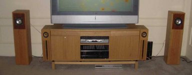

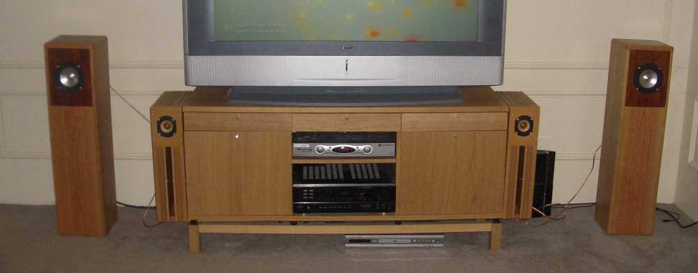

I just complete one D3-1.
It took quite a while due to excessive ambition/hubris regarding how to finish these, i.e., a combination of cherry veneer and piano gloss paint. I say excessive because this was a first attempt to do either. Despite the results being better than feared, had I known the difficulties I might have chosen a different appearance.
The actual assembly is pretty easy provided you can follow the instructions which are basically pictures with a minimal amount of text. A few point to watch for:
**Only peel back a little bit of the sticky-back felt at first. The larger sheets are floppy like to stick to one another, making something of a mess if you are not careful.
**Consider using your own hook-up wire. The piece that runs through the throat of the horn (as opposed to the one that routes through a short groove) is just a little too short when it come time to solder it to the driver. There is very little working space for iron, solder and hands (three required) making a trivial solder job into a significant aggravation.
** Study the section where you bolt all of the plates together with the 3x threaded spacers. If you get it wrong, driving then back out with damaging something may be impossible.
With only one I can't provide much of listening impression yet. When the second one is complete I'll post again.
