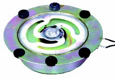

Essentially, the loudspeaker consists of a large freely suspended flat panel energised at a single point.
A moving coil motor may be used by bonding the coil directly to the panel and allowing the spider to support the mass of the magnet. The coil thus drives the inertia of the magnet, and because for every action, there is an equal and opposite reaction, the coil sets up bending waves within the panel.
Alternatively, a piezo bimorph may be bonded to the panel, thus directly bending the panel to set up the bending waves.

The rubber sealing gasket can be gently pulled away, and the cone cut away from the perimeter of the basket using a scalpel. A pair of nail scissors can then cut the cone from the coil former (except for the areas supporting the lead-out wires from the voice coil). The tails from the voice coil should be de-soldered from the tag strip, and the basket cut away from the magnet using a pair of tin snips. Using the scalpel, cut way most of the metal foil dust cap to reveal the coil former. Using the nail scissors, carefully trim as much of the remaining cone away as possible, ideally leaving only the coil former with very narrow
strips (1mm) of cone supporting the voice coil wires.
Motor positioning was chosen using Golden Mean (1:1.618) proportions, and placed 29.5cm along the length, and 16cm across the width.
The motor is fitted by glueing the voice coil former to the panel with plenty of super-glue. Light, flexible wires can be super-glued to the panel prior to soldering them to the voice coil tails. Finally, firmly super-glue the cone tails to the panel.

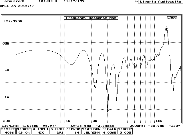

Results:
As predicted, if the panel is positioned vertically, the magnet rocks and scrapes on the voice coil, producing distortion. From the point of view of voice coil scraping, the ideal panel position is horizontal, with the motor hanging beneath the panel.
The foam cored card is quite expensive (£11), but the donor loudspeakers were very cheap, so the finished loudspeakers cost only £15 total for the pair, whilst taking one hour to make. Despite this, the sound is subjectively far better than might reasonably be expected!
There is little bass below 150Hz, and overloading the loudspeaker
at low frequencies produces some very odd noises, but the
overall trend of the midrange and treble is surprisingly good. (A measured frequency response is attached.)
The prototype loudspeaker is quite inefficient, and a 10W amplifier could not make it go very loud - but as the donor loudspeaker was only rated at ½W, caution might be wise!
NXT say that the DML is almost perfectly omni-directional, and this surprising claim was confirmed, and because of this ideal directivity, DMLs have recently been installed as the surround loudspeakers in the film screening room at Tobis (Portugal). As would be expected, there are no boxy colourations. One of NXT's more surprising claims is that the DML does not suffer appreciably from the inverse square law, and that sound intensity falls only gradually with distance from the loudspeaker. Amazingly, this claim too seems to be true over the close and medium field.
Despite being marketed as a wall mounting loudspeaker, the prototype DML does not take kindly to being placed near a wall, and produces a "cuppy" colouration. Its surface does not like touching any rigid surfaces. The voice coil rocking problem could be solved by a donor loudspeaker having a dual suspension, but these are rare. Traditional Alnico or more modern rare earth magnets are smaller diameter than ferrite magnets, and might reduce rocking.

Congrats. Great research!
If you have the facilities, I wonder what a step response would look like.
The only really bad parts of the response are those three notches between 2KHz and 4KHz. Otherwise, you have a decently smooth response.
Looks like you might really be onto something.

EC8010,
Interesting measurement. looks like you have summing and cancelling of the front and rear waves, but dipole rolloff doesn't begin until later. How close was the panel to walls/ceiling/floor during the measurement?
Perhaps a small frame could be built to both suspend the panel from the front, and the driver magnet from the rear, similar to this:
http://www.linkwitzlab.com/m_panel.htm
This would keep them aligned and hopefully allow vertical placement. It will be interesting to see if the peaks and nulls move south, or if they are a result of summing and cancelling of modes on one side of the panel. I've seen data that other dipole planars and line sources have floating nulls and peaks which change with distance, but this panel is producing in phase and out of phase info from both sides. Question is, How audible is it? Is it averaged out at listening distance?
Maybe you could use a reconing kit to attach the panel to the frame at different points ?
regards,Jason

diypole said:How close was the panel to walls/ceiling/floor during the measurement?
The panel was about 1.5m from the nearest boundary.
Yes, a frame can be made, and I have done so. The frame is about 2ft by 3ft, and supports the panel all round the edge in the manner of a trampoline (lots of knicker elastic). The advantage (apart from vertical operation) is that a heavier motor can be used, which improves efficiency (ratio of motor mass to panel mass). However, aligning and fixing the motor so that the coil doesn't scrape is difficult, and I haven't yet succeeded. despite this, the panel is much more sensitive, and produces some bass, but at the expense of HF. It seems that 7 octaves is the limit, and a heavier motor on the same panel simply shifts those octaves down in frequency. Unfortunately, I donated this prototype to my previous employer, but if I have time, I will pop in and take a few photographs, and post them.
I can't currently make loudspeaker measurements as my new computer won't accept my old soundcard.

Aura Shaker Motor Assembly
One of these thing from Jaycar might be suitable to drive a panel if you attached it to the bolt in the centre. No more voice coil scraping problems then. It is supposed to be subsonic, but it may have a useable response where you want.
