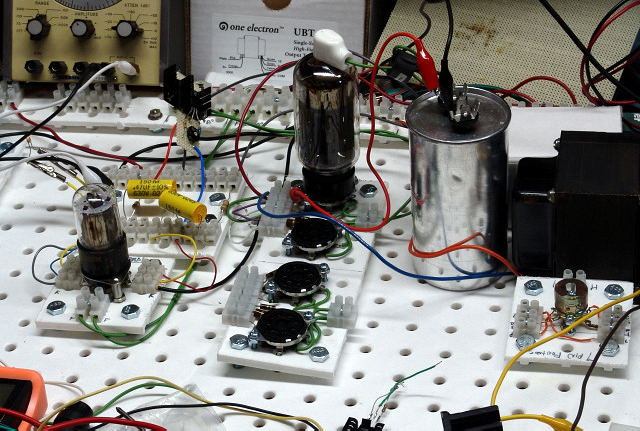

Today, I had some time to experiment with a cathode follower amp. I built a very simple driver that could deliver 490 volts peak to peak from a 550 volt supply. Then I started thinking (very dangerous). To make any serious power from a cathode follower, I'm going to need a lot of B+ voltage. The most my bench supply can give is 550 volts. I need an OPT, but the lowest impedance transformer that I have is 3K ohms, and it is rated for 110 mA max. If I want to be able to test at full current (and maybe more) I am going to need a tube that can dissipate about 50 watts. With the thinking part done, I went for the biggest tube in my junk box, the 6LW6. These will laugh off 50 watts.
So, I wire one up on my breadboard, and crank it up.
