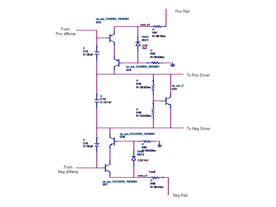

Looking at the suggestion above, I'd like to shar e my experiences.
I have tried the balanced differential vas with cascode both in simulation (superb results) and in practice (could not measure THD as I don't have the gear yet) on a circuit. If you cascode the differential VAS, you tend to ge t latch-up in most cases with the output swinging either fully high or fully low. This problem cannot be solved with an auto offset control via the input diff amps because the problem is actually in the vas stage and the diff amp(s) cannot influence it - it requires a balancing cct around each differential vas stage. I have not worked that out yet, but looking at Stochino's design, I have a feeling some of the 'glue' transistors he used around his vas are doing this. His topology is different to yours, but the cascode problem is the same. You get the same issue by the way if you use a current mirror load on th e front end diff amp in a balanced (but not differential) topology. Glen Kleinschmidt looked at this one on a post a few months ago, but there is no easy solution.
For your immediate problem, I'd suggest you go for matched integrated devices to improve the situation. For very tight matching you can use the high performance integrated matched npn and matched pnp SO8 pairs (e.g. modern equivalent of MAT01 types) or you might want to try the dual npn and pnp pairs from say NXP. These however are just small signal transistors assembled in the same package - they are not tightly matched but will be off the same wafer and closely located during the assembly process.

did you build your circuit and try it out? My VAS was very similar (all bipolar though) and I got the imbalance problem. If you take th e cascode out, the problem is reduced or removed. With single ended differential VAS there is no problem but with a fully balanced design it latches up. You will not see this on a simulation by the way.
have you looked at the voltage drop across the collector load resistors (Vr6 & Vr7=45V @ 2.5mA).
Add on the base voltage of the cascode pair and you need at least 59Vdc on the supply to run the cascodes at a tiny Vce=2.6V
Is that what you intended?
I suspect the front is not working and that's where it starts going wrong.

Andrew,
There is nothing wrong with the circuit in this respect - it drops only about 15V across each of R6 and R7.

You've forgotten Q5, which sources 3.4mA into Q7 (via the zener). The balance goes via the diff pair (800uA each side). This results in 14V across R6 & R7.
The topology is a good one. I've built a really good amp already using this topology (see http://www.littlefishbicycles.com/poweramp/). It appears to be simply the complete lack of thermal tracking in the intermediate stages that's biting me.
working with what you have in hand I would make a few tweaks on the board before just changing devices
loose the gnd between R17,18 if anything needs to track its the refs for these ccs
add trim pot to R19 or 20 to be able to balance mje tail curents so that the Q11-14 pairs are operating a precise balance themselves, less important but possibly trimming the MJE degeneration R could also prevent this stage' imbalnace from forcing the previous Q11-14 from operating with a noticable inbalance
you could cut your board traces and add series collector R to Q11-14 to operate the Qs at the minimum power sensitivity bias point (dropping equal V in Q Vce and total collector R)

I'd go along with this suggestion, perhaps with the addition of 100pF C's in //, not to alter the HF behavior.
Another aspect that might contribute to the problem is the "non-perfect" differential driver stage: the degeneration resistors with the tail resistor form a T attenuator that might prevent these stages from differentially cancelling the distorsion from the previous stage.
I'd also think of using "creatively" the collector currents from Q15 and 17, instead of simply dumping them to the GND. I've no precise idea yet, but I think it's worth some moments of reflection.

VAS Distortion
In taking another look at the fully differential VAS, I think I know what is happening. In order to operate correctly a 4-transistor VAS needs to maintain each VAS device in its linear region. Any deviation from that point will result in distortion. This means that the voltages presented by the second differential stage must be exactly matched to the Vbe characteristics of the four VAS devices. This is not easily achieved.
I would consider a more conventional VAS stage consisting of a pair of cascoded devices as illustrated in the attachment. Setting the idle current in this topology is substantially easier. The use of a voltage reference between the devices in the cascoded pair guarantees a fixed bias voltage within the pair. The only critical setting in this topology is to ensure that quiescent Vbe across Q13 and Q17 is set to approx 600 mV. During operation you should see less than 1 mVPP voltage swing across these points.
I have found this topology relatively insensitive to device selection and/or PVT variations.
