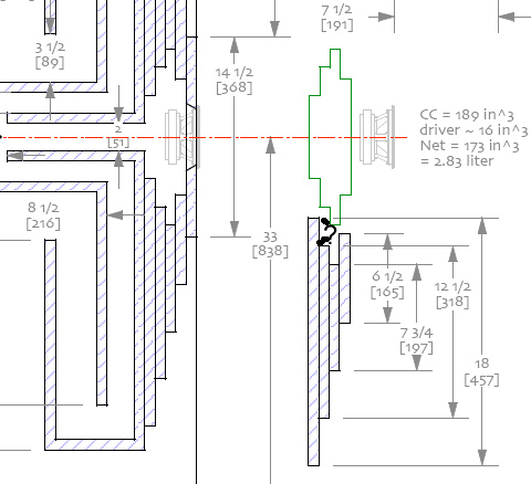

mikasa question
on excellent file by Scottmoose, I am unclear on the behind the speaker chamber steps, the size of the plate is clearly given but the measurement of step down from the next plate is unclear, hope the attached file explains my dilemma.

Good question Greg. I sent a PM in response to your own, but in case anyone else is wondering:
If you look on the pdf file between the dimensioned diagram and the CAD render, you'll see a series of vertical lines with heights marked off. These give the respective distances of the ends of the stepped front panels from the top of the enclosure, and thus, the internal layout of the back-chamber.

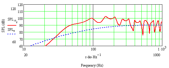

P.S. I haven't liked to mention this to Dave yet (in case he kills me), but I'm working on an alternative version of Mikasa, based on the Sachiko layout... this is the 1/2 space FR of the MCM unit in the new box. Not lacking for gain...

planet10 said:
I have revved Mikasa plans to add the information Greg was missing....
http://homepage.mac.com/tlinespeakers/FH/download/Mikasa-1v01-map-070707.pdf

Scottmoose said:
Excellent. 🙂 I tried to explain it to Greg, but I'm afraid my literary skills let me down. Guess I should stick to my protected & armoured cruisers and driving MathCad. 😱
Plant10 and Scottmoose:
thanks for letting me continue this madness of building better mousetrap, (sorry speakers).
Exactly what I needed...
