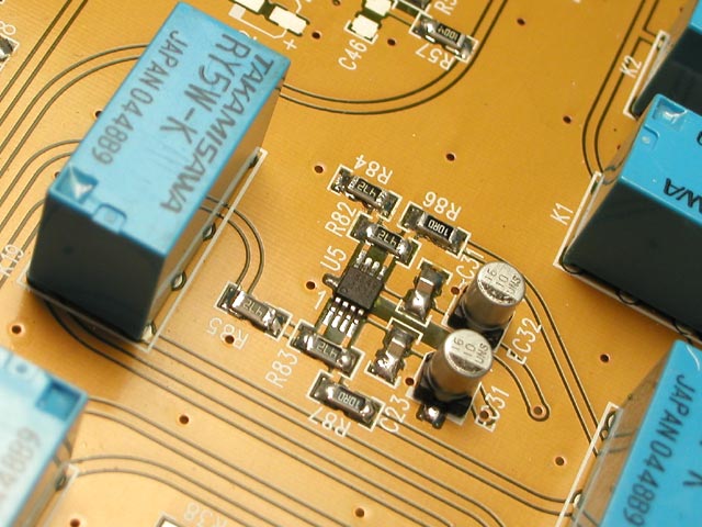

I'm using the OPA1632 in my new preamp.
I choosed the DGN package with thermal pad underneath, and have followed the powerpad layout suggestion.
This chip consumes quite large quiescent current of 14mA. The extra heat should be taken care of, if running with +/-12~15V supply.
