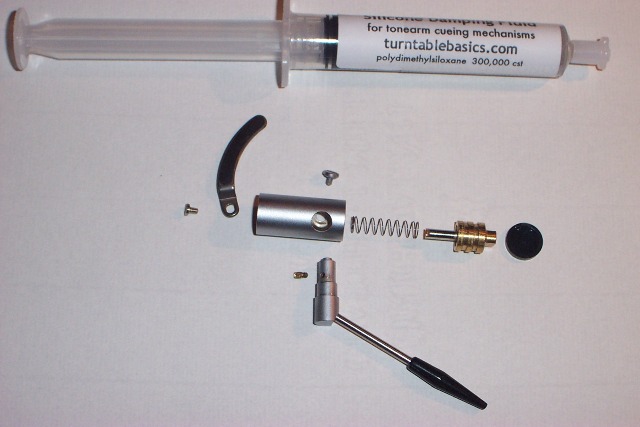

Grace 707 tone arm damper fix
Confirmed fix.
Thanks Coolmaster, your suggestion with the 300cst silicon works 100%. I ordered a tube US$10 (I think) from Turntable Basics and completed the fix last night. see http://www.turntablebasics.com/silicone.html for the product.
Here is the repair in detail;
1. Cover the Cartridge Needle to protect. (I used the original stylus cover)
2. Remove Arm Rest top screw and remove Arm Rest. (curved piece)
3. Loosen Piston Clamp screw
4. Loosen Arm Lock Screw (on side of main Tone Arm shaft) to allow whole Tone Arm Assembly to rise up sufficiently to drop the complete Piston Assembly out the bottom of the Piston Clamp.
5. With the Piston Assembly removed, using a sharp blade prise off the black plastic Base Disc (take care, slight damage to the edge of the plastic is likely).
6. Look inside the Piston Cylinder and remove the small bronze Grub Screw located on the Lever Arm shaft (only takes approx 1 turn).
7. Remove the Lever Arm screw located on the opposite side to the Lever Arm.
8. Carefully, holding the Piston Shaft in the "raised" position, remove the Lever Arm.
9. Allow the Piston to "spring" back down and slide it out the bottom along with the Return Spring.
10. All components to now be throughtly cleaned, I did not have any rubbing alcohol so used mineral turpentine.
11. Thoroughly dry all components.
12. Assemble Return Spring back on to Piston Shaft.
13. Coat only the bronze Piston sides with the 300cst silicon, ensure the bronze Piston grooves are full. I used a small piece of cardboard as an applicator to build a very thin layer over the Piston sides. (do not cover the top or bottom of the piston)
14. Carefully slide the Piston (with the Return Spring) back into the Cylinder.
15. Hold Piston in the "raised" position (with a cotton bud) and re-fit the Lever Arm and Lever Arm screw.
16. Rotate the Piston to align the Piston "dog" with the Lever Arm cam.
17. Test assembly for smooth action.
18. Re-fit small bronze Grub Screw (this controls over rotation of the Lever Arm when in the "raised" position).
19. Re-fit black plastic Base Disc.
20. Re-fit Piston Assembly into Piston Clamp on Tone Arm body (do not tighten clamp yet).
21. Re-fit the curved Arm Rest (note this must align with square sides on Piston Shaft) and tighten Arm Rest top screw to secure.
22. Adjust Tone Arm height and tighten Arm Lock screw.
23. Adjust and secure Piston Assembly in desired position using the Piston Clamp screw.
24. Done.
My first attempt took approx 2 hrs. I had never dissassembled one of these before. I added too much of the silicon and coated everything inside the Cylinder as well. It worked but irratically, sometimes taking 2 minutes to drop, sometimes 5 seconds. I believe having too much silicon created an air-lock above and below the Piston which also caused some weeping of the silicon out through the Lever Arm screw.
My second attempt took 30 mins and the result was perfect function. Needless to say, the instructions above are from my second attempt. No weeping anywhere. Perfect repetition of dropping action. Cartridge takes approx 3 full seconds to drop.
See attached photo of disassembled parts.
Hope this helps.
Thanks again to Coolmaster for the tip on what type and where to get the silicon.
For info, I also spoke to Dow Corning who could only get me a 500ml tin of their product and never rang me back with availabliity or price.
24. Done.
Hope this helps.
