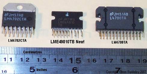

About 10 minutes after that post the nice UPS guy knocked on the front door. Ripping into the package and pulling out the camera....
The LME49810 is in the middle, with a ruler for scale. It is flanked by a LM4702 and LM4780 also for scale. It has tiny pins like the LM4780, but at least they don't have to pass the full speaker output current! 2mm pin spacing on the left and 4mm pin spacing on the right.
