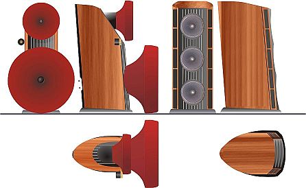

more pictures at :
http://www.flickr.com/photos/audiovoice_hornloudspeakers/
your comments and sugestions are welcome.

Intersting,
but I found something even more intersting than the pictures. Could you detail a bit on that 2" special Coaxial compresion Driver/Tweeter in Audio Voice Sonata?
I don't remember seeing anywhere a dual concentric compresion driver... so this must be something special..

coax driver
hi
the coax i use in the Sonata is a modified BMS4592nd coaxial driver.
In the Goliath however, i split de frequencies and the drivers.

Interesting design, and I'll watch it's development with interest.angeloitacare said:more pictures at :
For work reasons, I'm currently living in another city and had to dismantle my horn mains and LABhorn subs and go back to direct radiators (KEF 104/2).
I'm in the planning stages for a new and improved rig when I return, based upon my previous experiments. Current plans call for Azura 240 horns with a small coax (Radian, Hemp or BMS) from about 200Hz up and a hypex driven by a pair of 15's from there down to about 60Hz. Subs will be IB's in the ceiling with the 24 15" drivers I have laying about.

Dunno, but if ur a manufacturer, shouldn't you register as a manufacturer??
Looks like a commercial site for ur link??
But the computer renderings look nice... or are those photoshopped pictures?
Is Fane still in business? Thought they went under a few years back, iirc.
