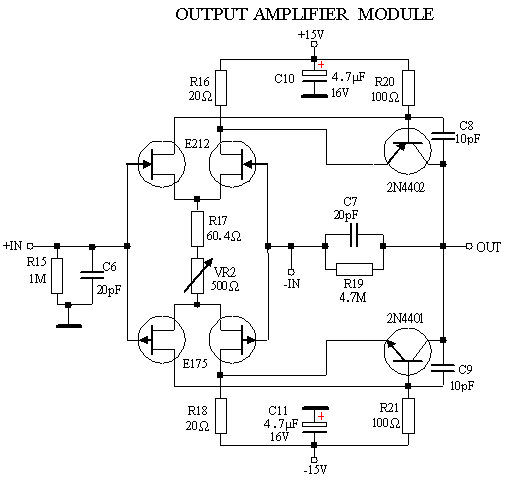

I am prepare to build John Curl's JC2 preamp. However I am not electronic expert. I do not know the purpose of the 100R trim pot in the phono stage and the 500R trim pot in the ling stage. Does anyone can help to tell me the purpose & how to adjust these trim pots to get the best performance of this preamp circuit?

The 500 Ohm pot in the line amp sets the quiescent current of the inputstage and the 100 Ohm pot in the phono the offset.
Please note that the linemodules in real world have two pots. One is controlling the offset but not shown in the schematic.
I believe the schematic is a very crude and early one. I opened some defective modules with boiling antifreeze. (ates away the epoxy a bit) and found MPSU05 and MPSU56 outputtransistors in the modules, NOT FET's. (Also obsolete tranasistors) Also the line amp is slightly more complicated. And input FETs were 2N4392 and 2N5115 (metalcan).:cool:

I read your post in the Audioaslyum before I posted this thread regarding the JC2 preamp. I am not familiar with electronic theory I would like to learn more about this circuit:
1. Does the circuit posted on the marklev.com is a workable circuit that I can knock off without any problem since you said the circuit is a very crude & early one.
2. Where should I take the measurement to read the quiescent current in the input stage?
3. How much quiescent current should I get by adjusting the 500R pot in the iput stage?

I built this circuit using GR (Idss: 2.6-6.5) grade 2sk389/j109s and ZTX450/550s, but forgot about the need to change the drain resistors. Can someone please tell me what value drain resistors I should use instead of the original 100ohm ones? Thanks in advance.
As for Fred's suggestion to cascade the J-FETs, my layout is kind of small, so I'd really like to get this circuit working with just the resistor change.

Folks, the JC-2 is not an EASY design to make. Many of the original parts are obsolete. The circuit topologies are still viable, and almost typical, today. Thirty years ago, this was an advanced design. Elso has not been productive in improving this design, and while I respect his opinion, I find errors in his estimate of the sound quality potential of this design. Done right, it can still keep up with most anything today. There are some oversights, however, that we made in 1973-74, that need to be fixed. We attempted an upgrade to existing units in an article a few years ago in 'Positive Feedback' written by Chuck Hollander. It might be useful to find this article on the internet.
