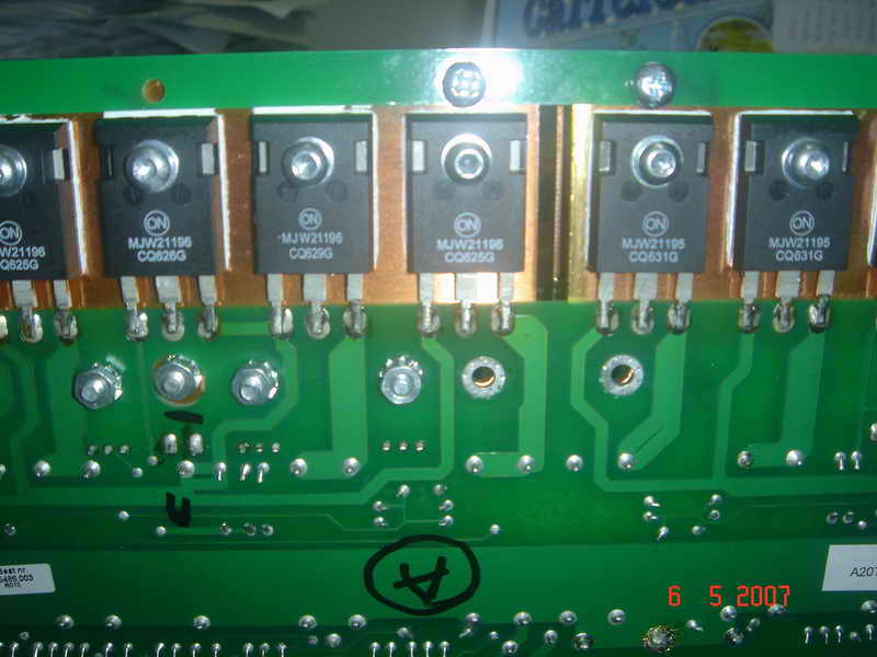

The output bipolars are different than in your picture. In your picture, the output are A1294/C3263, while in FP6400 modules, the outputs are MJW21195/MJW21196.

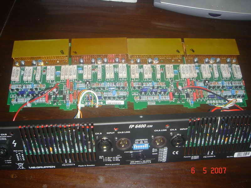

Anyone got suggestion what to do? Since this amp is already disassembled (Darkfenriz tells me too late 😀)

lumanauw said:Hi, Kanwar,
The amp in my picture is FP+10000Q series....

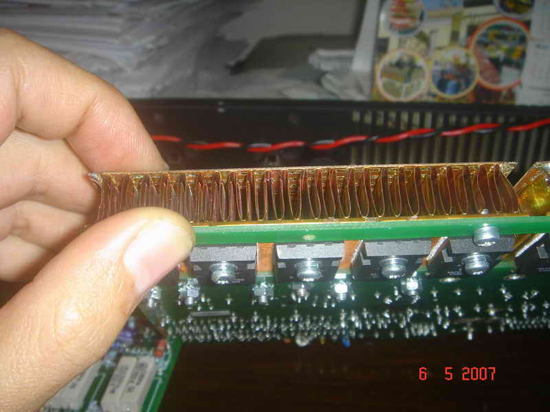

Please Post some more pics of Smps and Class-TD coils circuits....that would be good....

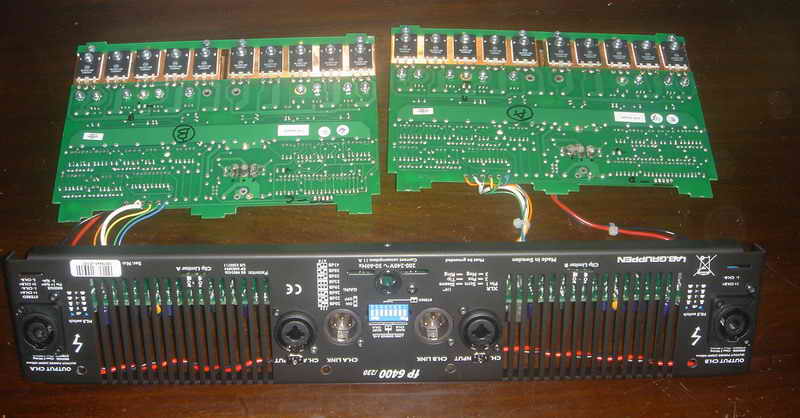

This amp is divided into 2 sections now. The input+audio modules are in my house and the casing+TDmodules+main SMPS are in my friend's house. The SMPS is really scarry. Maybe even EVA has not seen the ferrite core of this size. I will take pictures tomorrow.

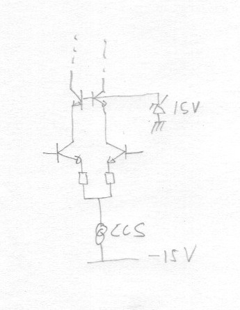

I found the first "doable" modification. The input differential is rather strange. The rails are +/-155V. But the NPN input differential are current sourced from only -15V. Also on the top of the input differential it is cascoded at +15V. I think this will produce much early effect, because the non-inverting input of the differential pair could be driven by source that can have magnitude of +/-5V or more. I'm planning to change the CCS (that feeds the differential pair) from sitting at -15V to sitting at -155V. Also to change the lower of the upper cascode's zener to the emitors of the differential pair junction (not to ground) to make the differential input pair always has 15Vce, not modulated by input signal, to minimize the early effect (changing gain by changing Vce)
What do you think about this first idea?

You cannot change the CCS voltage from -15V to -155V, because the CCS has integrated with muting function also...the muting of this amp is achieved by disabling the CCS....Nor you can change the cascode zener reference, because the Clip detector actually detects the signal at the emitters of cascode...if you would change the reference from ground to pair junction than i think there could be problems arised with the clip limiter itself....
lumanauw said:'m planning to change the CCS (that feeds the differential pair) from sitting at -15V to sitting at -155V. Also to change the lower of the upper cascode's zener to the emitors of the differential pair junction (not to ground) to make the differential input pair always has 15Vce, not modulated by input signal, to minimize the early effect (changing gain by changing Vce)
LUMANAUW: Do NOT even THINK of GOING there!
