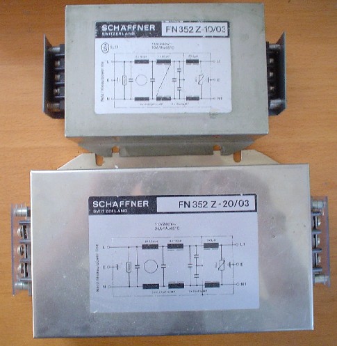

Stefanoo said:Is this idea crazy?
Nope.
But as an alternative you might go one step further and do what i do with all my audio gear.
Place a symmetrical filter behind the (grounded) wall socket and a balanced separation transformer after that before feeding the 240 Vac mains to the amplifier (transformer).
I use 10 or 20 amp filters with an oversized separation transformer (unfused, each separation toroid is around 5KVA nominal, all foil caps in the filters on the picture are MKPs)

jacco vermeulen said:
Nope.
2 of those setups for the monaural power amps, 1 for the pre-amp, 1 for the other stuff.
All four filter/transformer sets together weigh in at around 100kg.(perfect stuff for audio fools on steroids)
Peter Daniel posted on balanced separation transformers, how to convert a regular one to balanced operation, plus the production number of (an expensive) one made by Plitron.
