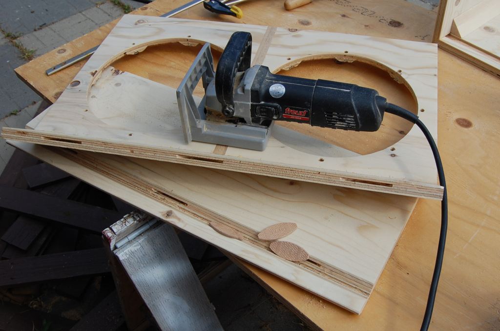

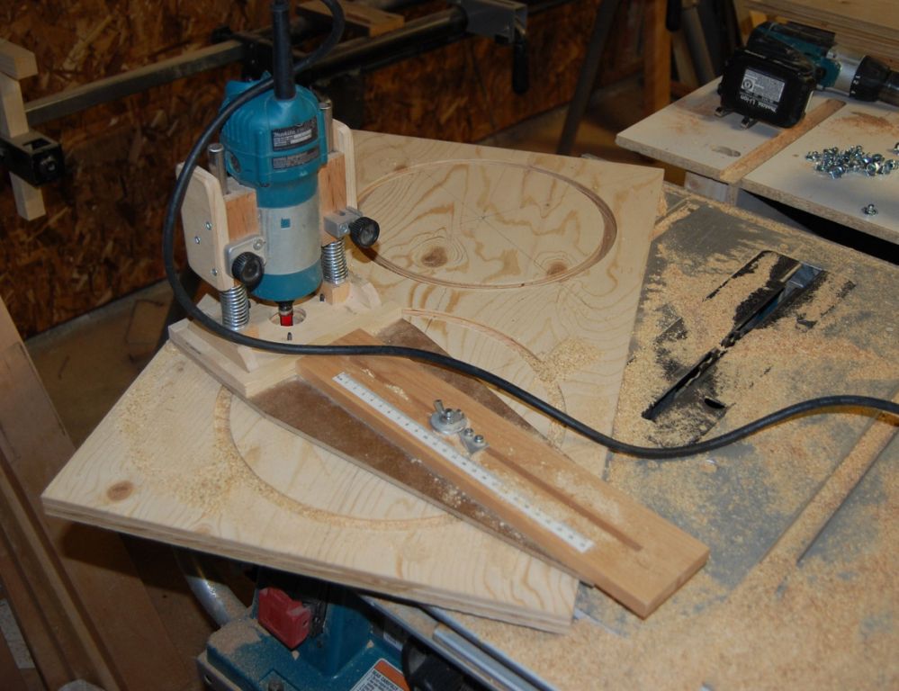

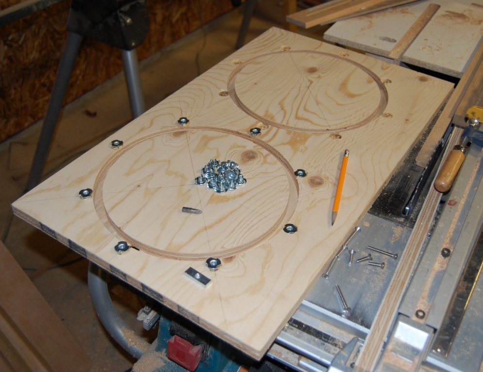

With the holes cut, I drill 1/16" deep countersinks with a 3/4" forstner bit for the t-nuts to sit in (they are now flush with the face...details 😉 ):

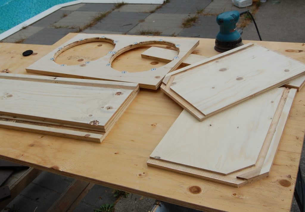

I then cut the other parts of the box - sides, top and bottom:
With all of these beautiful joints, assembly should be a breeze.

I didn't waste money on materials, just used up some of the leftover pieces of 3/4" spruce sheathing I have to build this box. Ran it through my thickness planer to make it reasonable, then sanded it. It ends up very smooth to the touch.

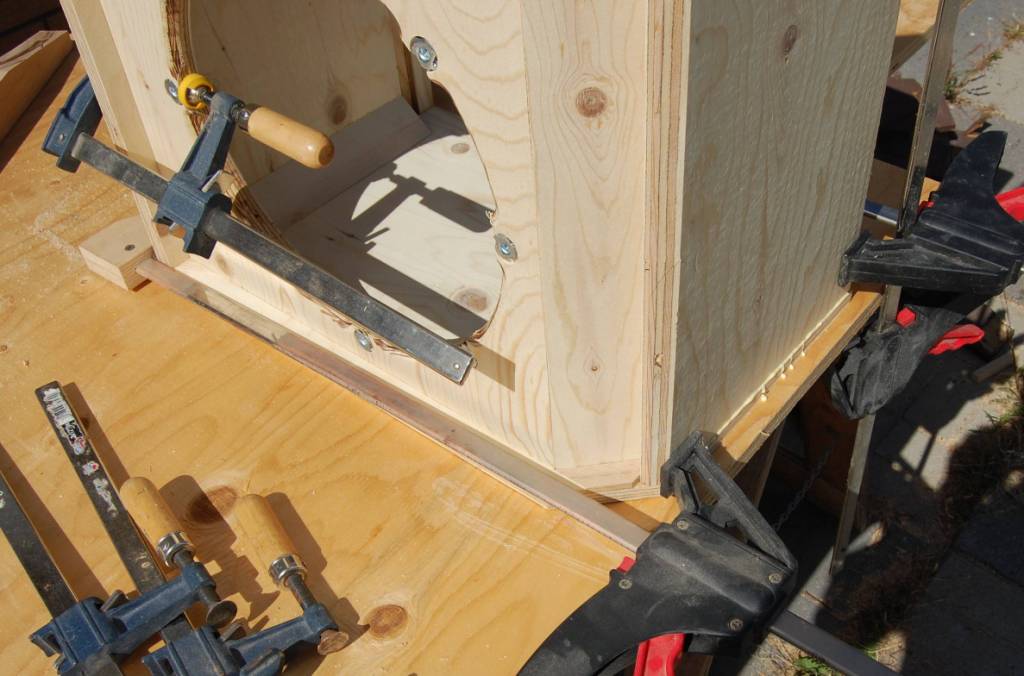

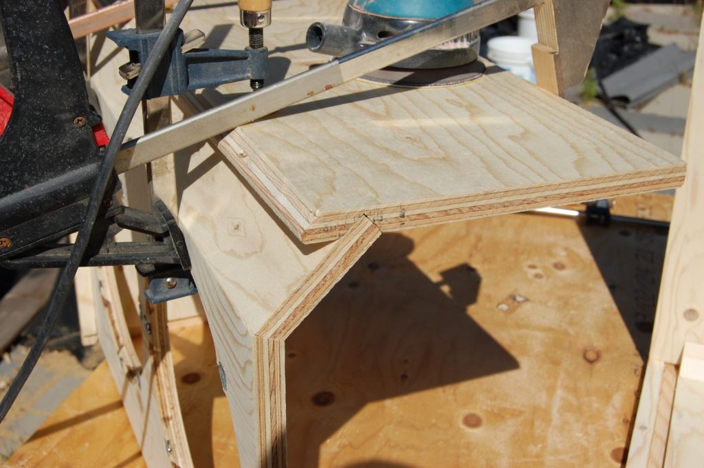

With all of the parts cut, assembly begins. The joints between the baffle and control panel and top are glued and reinforced with biscuits:
A side view shows how they fit together:

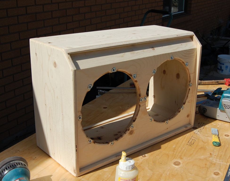

Clamps, a few brads and some glue secure the sides:
A few hours later, after the glue sets:
Ready for final sanding and some kind of finish.

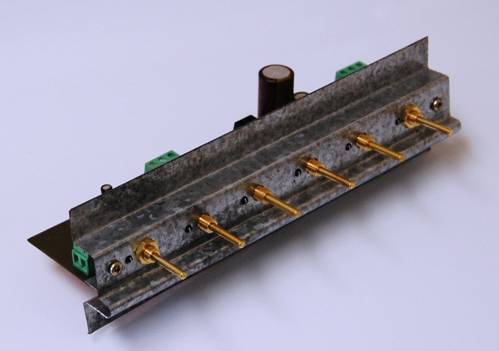

The preamp section and the "effects" section will be mounted on a bracket that will be attached from the back of the sloping panel. I will carefully cut the appropriate size hole to house these.
The preamp. It requires a hole `1" x 8" through the panel. Yes, it is tougher to cut these now but I'm up for it.
Once all of the parts are in place on the panel (including jacks), I'll make a faceplate from thin stainless to cover everything.

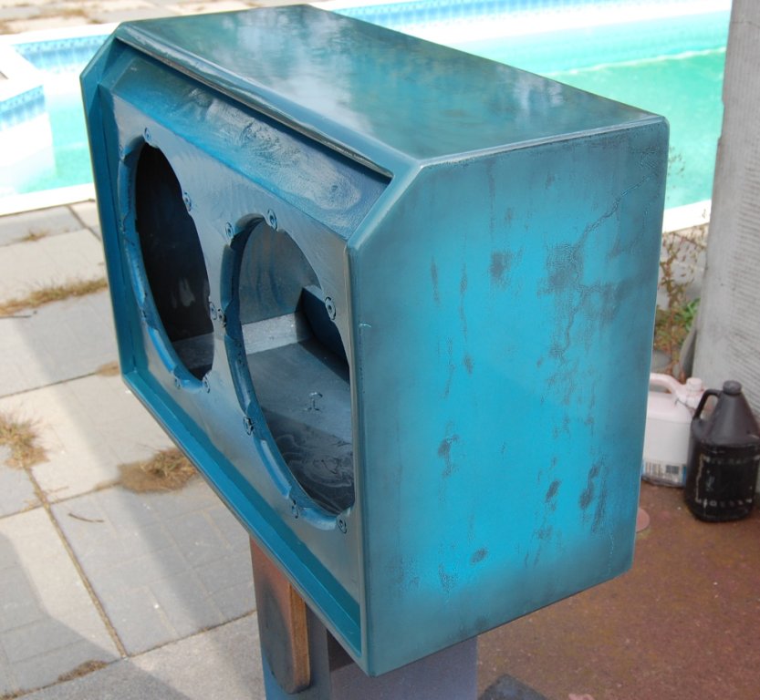

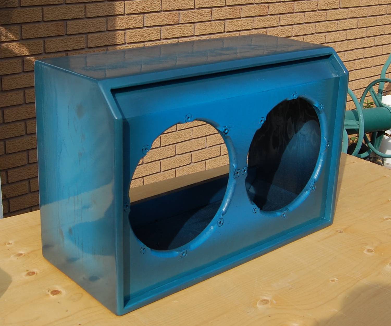

Moving on with construction, I had some decisions to make after the box was put together about how to finish it. I considered Tolex but I'm not big on glued on vinyl and it's kinda plain, boring. I want the things that I make to be eye-catching, unique and artistic (if possible). I thought I could do a funky paint job - take advantage of the hard to cover grain of the cheap plywood I used to add to the effect.
I started with black enamel, sprayed on heavy, to build up a thick coat rapidly - the idea was to create some sags in the paint and get to the "wrinkle" stage, where the top layer is drying but the layers underneath are still wet. This causes the paint to wrinkle - a good effect.
Letting this dry overnight, I switch to a bright baby blue and spray on several coats of this. This causes the black to wrinkle even further.
I let this cure for a week and then start sanding with the random orbit sander and 100 grit paper - the idea is to make it flat and also to expose some of the wrinkled black underneath. Once I'm satisfied with how much is showing, I switch to 400 grit paper and make it as smooth as possible.

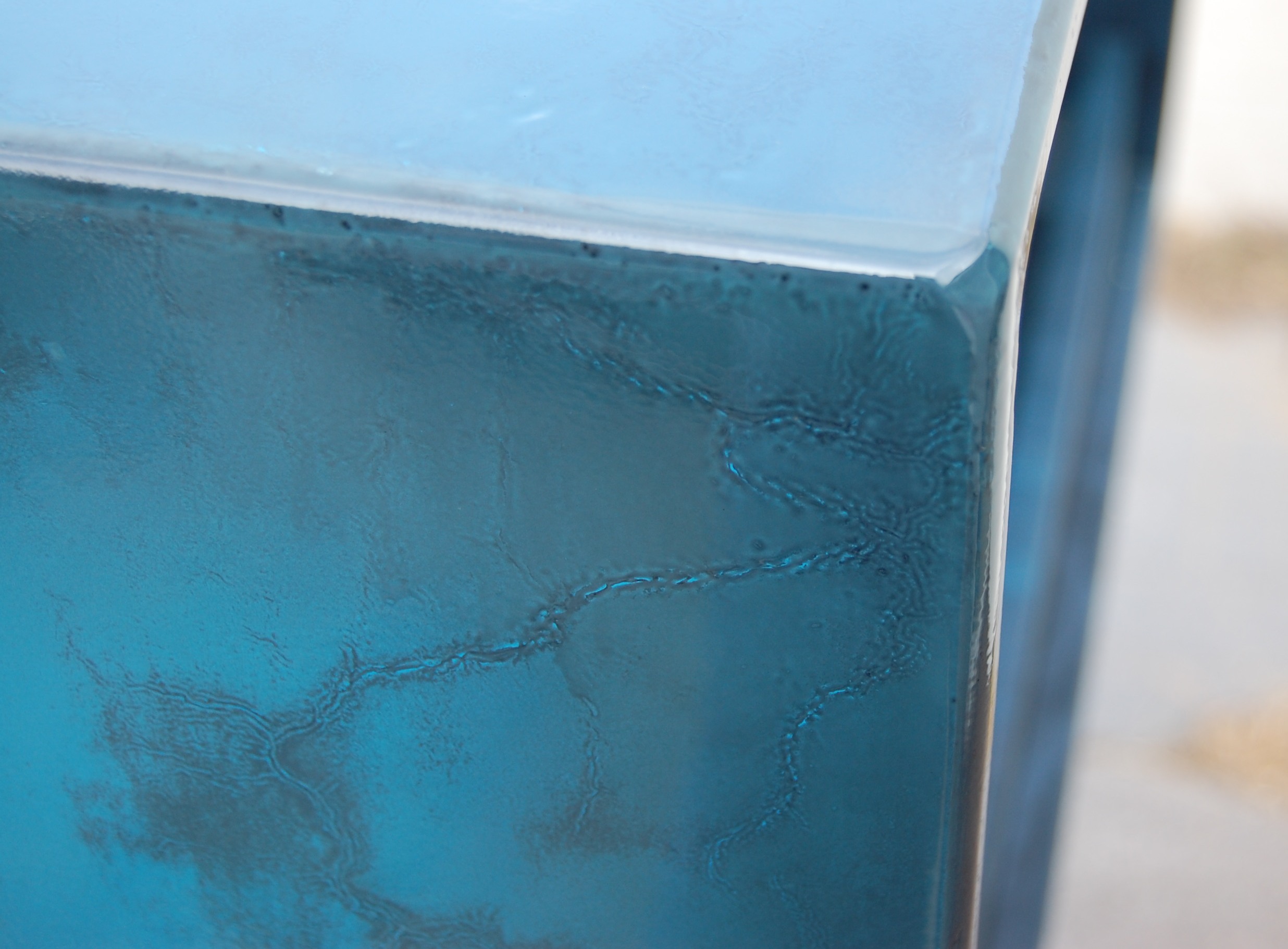

Next step, mix a little black with clear urethane and "flame" the edges. A few coats later and the desired effect is achieved.
The next day, sand smooth again with 400 grit and this time I mix a smidgen of the baby blue with the clear and overcoat the entire box, giving extra on the edges. At this point the colour is nearly where I want it.
To mellow out the colour even more and to give the smoothest possible surface, I sand smooth and shoot on several coats of clear (no tint) the following day.
This sounds like a lot of work but really it wasn't. I just takes time, the actual painting goes very quickly and is fun - probably a lot more fun than cutting and gluing on Tolex (cheaper too, I had all of the paint and clear already).

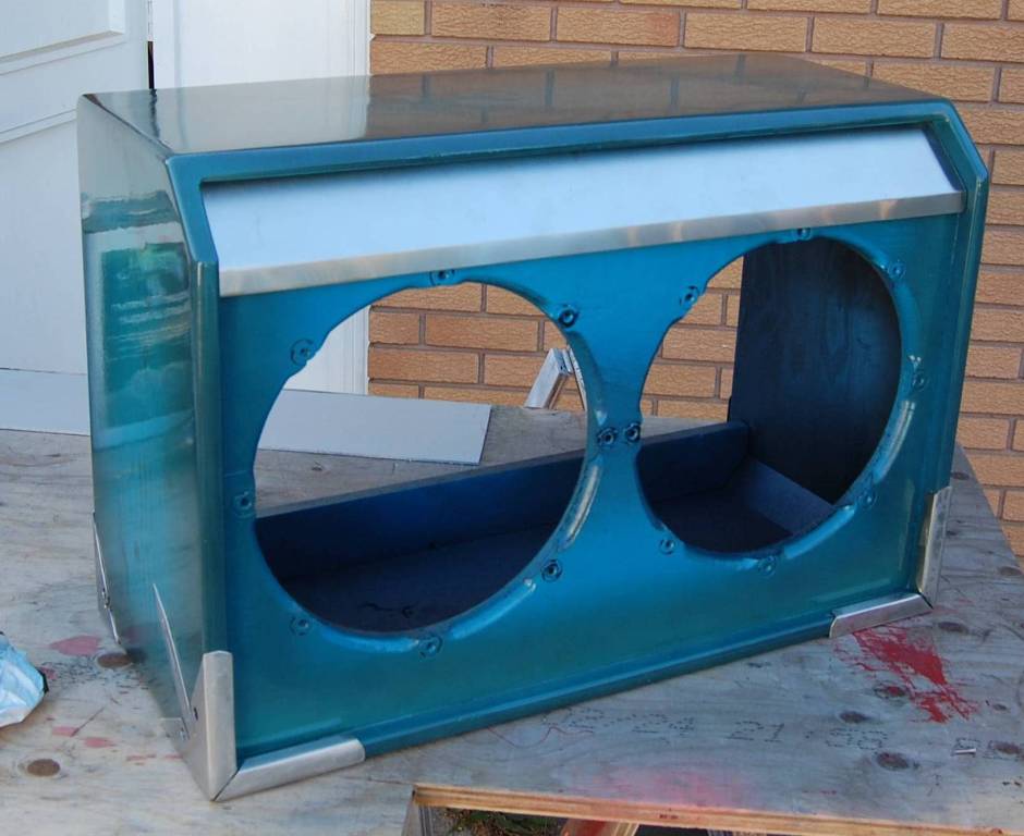

Here's the overall look:
The baffle will be repainted black later. Another view:
And a closeup of the finish:
I'm very pleased with the results. 🙂

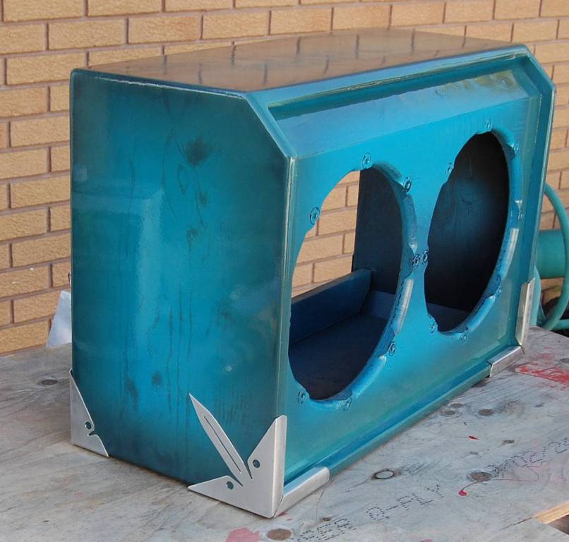

Some metal work.

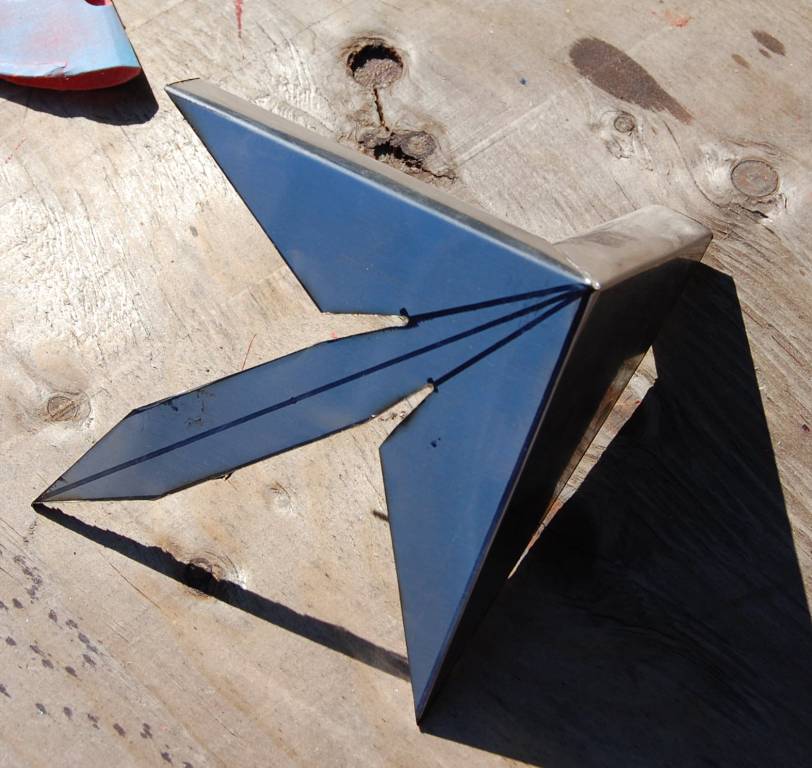

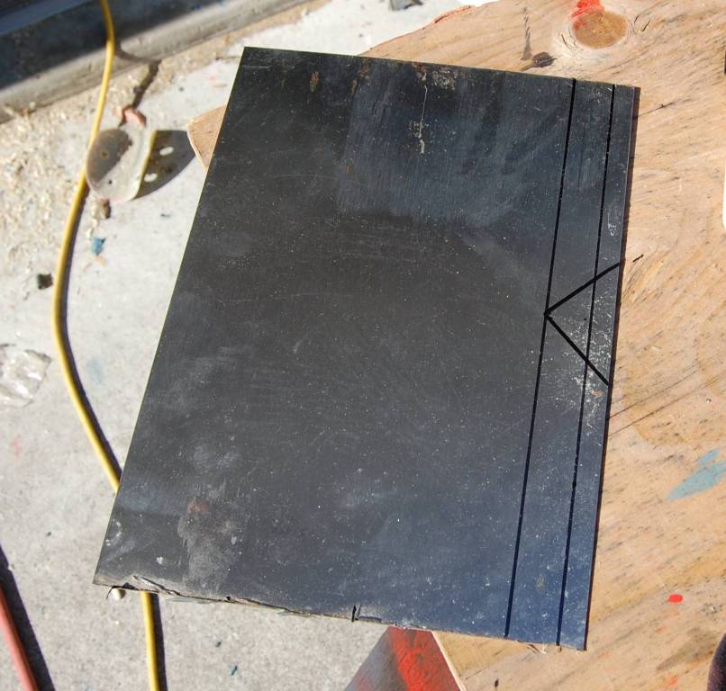

The corner protectors I've seen are plain and boring - being an industrious sucker for punishment, I figured I'd make my own. I planned the control panel faceplate to be stainless steel (I have lots of this) and so to match that, I'd make the corners from the same.
I am using 16 gauge stainless that is surplus kickplates for doors. It's hard to cut and drill but not as bad as better grades of stainless.
Some layout:
And the first cuts. Notice the scores with the cutting blade along the lines that need to be bent. This makes bending this thick metal manageable:

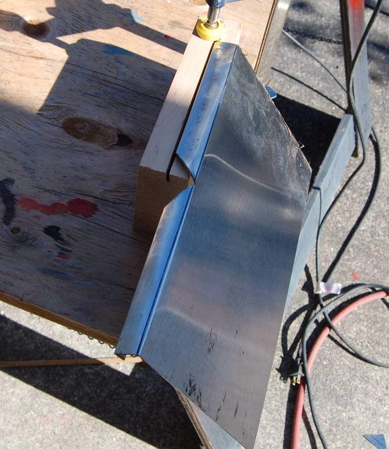

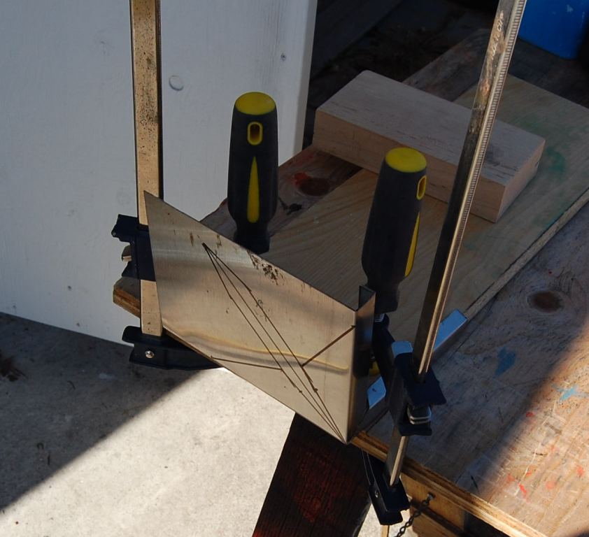

Bending:
I used a block of hardwood with a slot cut into it for the metal edge to slip in and help with the bending. Some pounding with the hammer finishes it off.

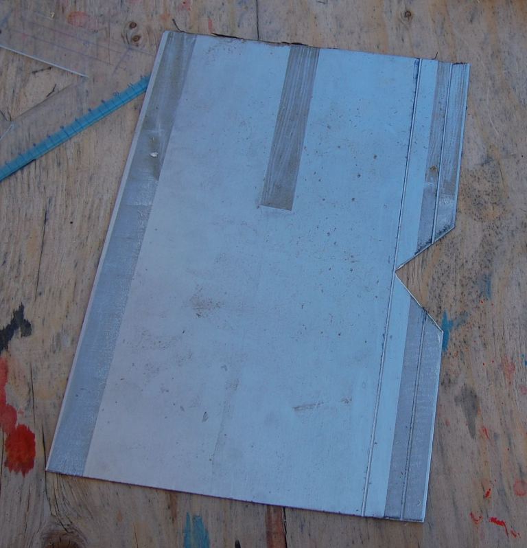

More bending and you can see a rough pattern drawn on the side:
And that shape cut out:

And the results:
I made the pair for the bottom/back different. I still need to do another pair for the top/back which will be different again.
The cut and bent front panel:
REALLY hard to bend this to that 45 degree angle and keep it from deforming. It will be held in place with a couple screws with the top edge wedged into the corner. The bent part is meant to clamp the grill cloth.

The corner was meant to look like a stiletto - a dagger
Thanks for the fine compliments. I have not done anything with the case since, I'm still working on the preamp section and I've taken an ambitious turn: I am reproducing the preamp and chorus from the Ampeg VH140C. See the schematics HERE.

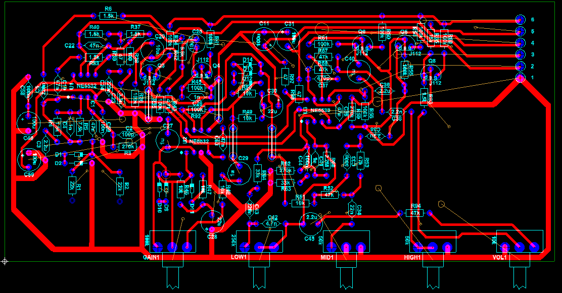

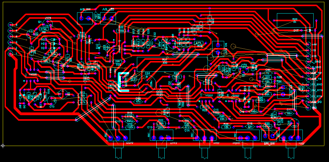

So far I have the preamp section boards laid out. I had to split them in two to get a size small enough to print and etch here:
The other half:
I forgot to read carefully. So, does DigiKey still carry the bucket brigade MN3001 chip? That's the only place I know that has it(had it?).

Ok, I started stuffing board 1, I have the jumpers and most of the resistors in and it only took 2 hours! Just to refresh your memory, here's board one (half of the preamp section only):
I feel helpless without my camera 🙁 unable to take any pics of the actual boards (pics are motivational). I'm extremely paranoid about the component values that are printed on the board. I have checked and re-checked them but I still feel like something is wrong...I need therapy.
After this board is assembled I need to figure how to test it for mistakes. Besides the input jacks, I have 6 traces that go to board 2, three of these are GND, +15 and -15. The other three I'll have to trace on the schematic to see their impact on the circuit.
