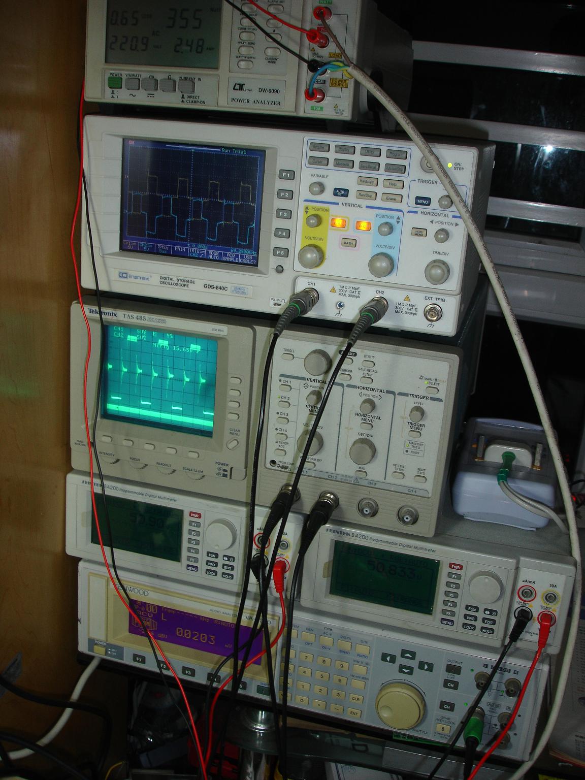

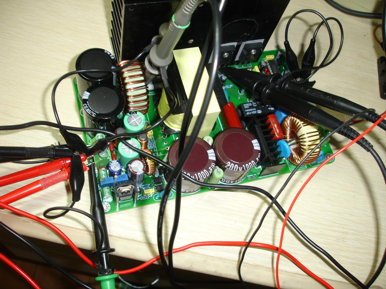

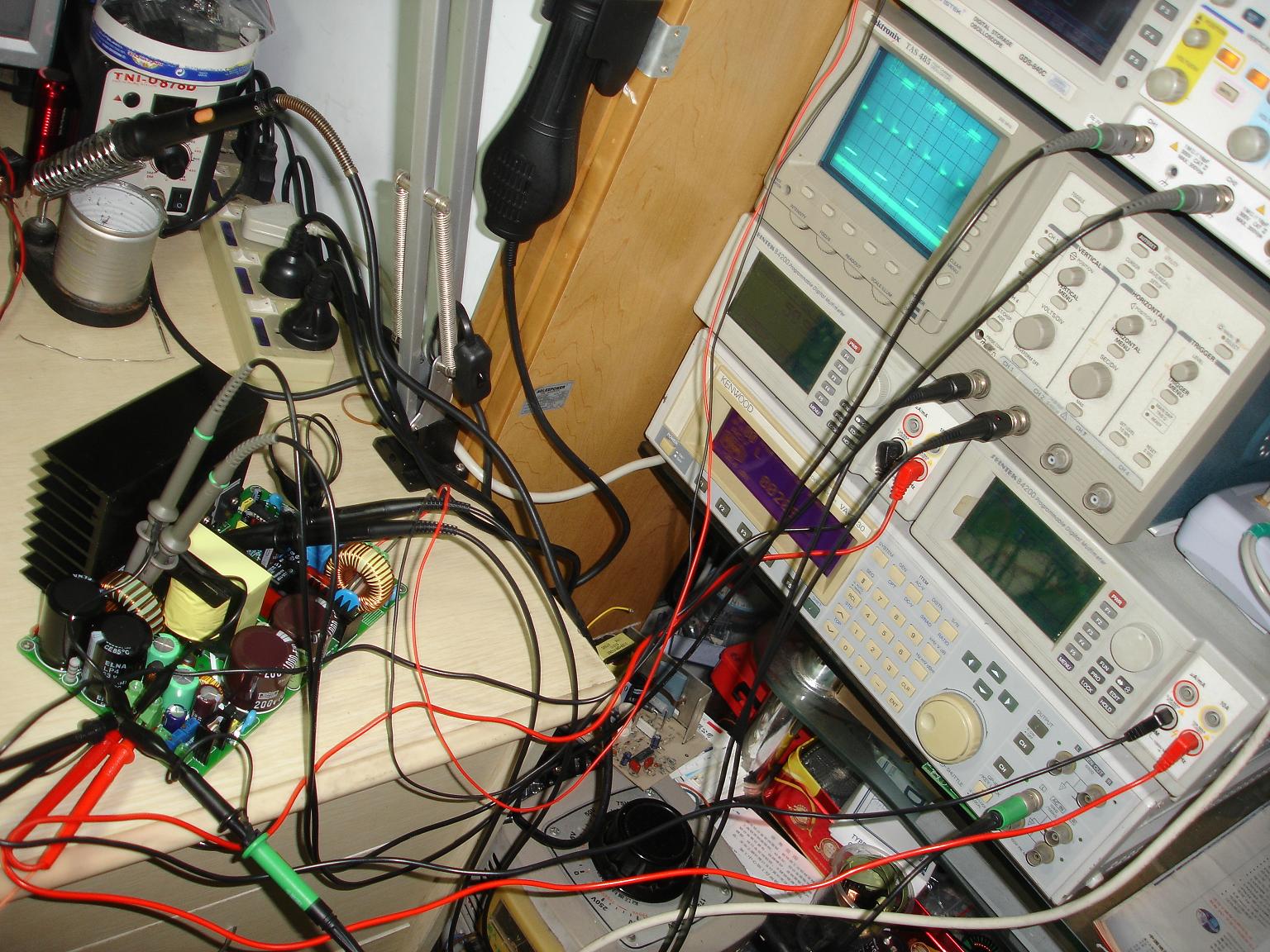

some test results. photos can speak for themself. on top of the instuments stack, is the Power Analyzer. this measure the input current, voltage, power factor and power. next, the upper scope, the digital one monitor the output vawe, directly on the transformer pins. the lower one, has one channel DC coupled on the bridge, probes set to x10 and scope at 5V/div, 5uS and another channel AC coupled, probes x10, 5V/div, 5us and is connected to vbus. what can see there is the AC ripple. the two multimeters from below the analog scope measures the output voltages, one for positive, one for negative. at the bottom, with the audio analyzer i measure the output voltage ripple at 3, 5 and 6A. the probe is x10, so multiply with 10.
on the other side lays the DC electronic load. because is rated at just 300W, i connected in series 2 power resistors to limit the maximum power, otherwise i cannot load the smps with more than 300W. the current reading is accurate, but the voltage reading should be added to the voltage drop on the resistors, wich is proportional with the current. anyway for accurate voltage reading, i use those 2 lab. multimeters below the scope.
i can attach just few photos, for more details, please follow the link http://www.poweramp.ro/forum/viewtopic.php?f=14&t=2&p=11#p11
