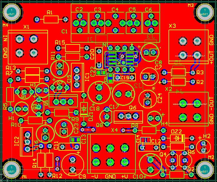

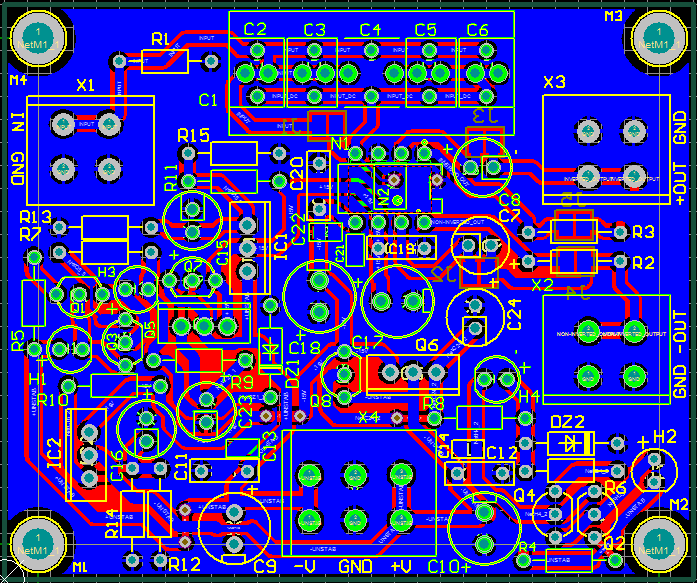

DRV134 pcb
The pcb look like this

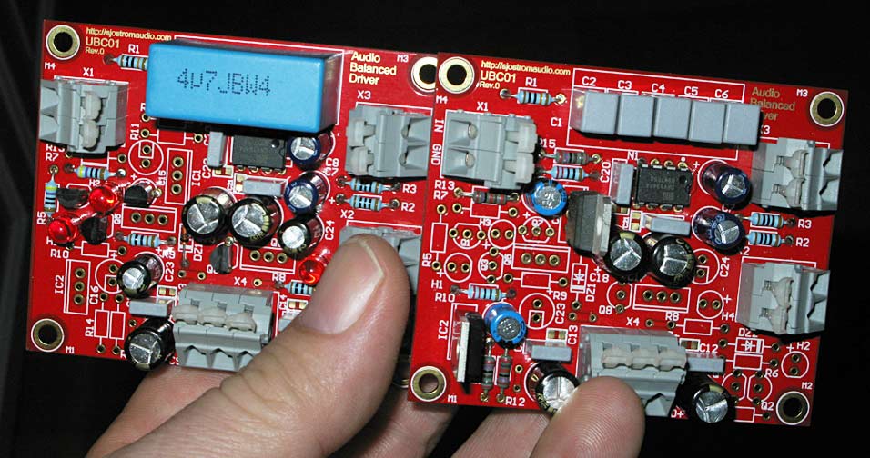

I have debugged the boards now and two errors were but the were minor.
Connector X4 should be +V GND -V, (is +V GND -V, just swap + and -)
Connector X3 should be -OUT (inverting output)
Connector X2 should be +OUT (non-inverting output)
It was right to connect the input coupling cap directly to pin 4 without any pulldown resistors.
