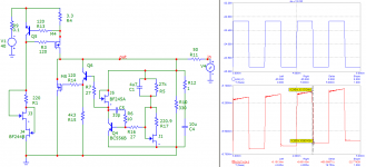

As you can see I was simulating ability to handle changes of output current. Output voltage was set to 24V. Input current was set to 200mA. Current at the output was set to 70 +/- 20 mA.
Peak to peak response of v1.1 was 52 uV and v1.2 was 450 uV. The shape of response is quite different.
It seems to me, that v1.1 is responding a bit better however there maight be other characteristics, that are opposite to this.

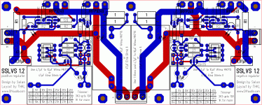

Changed the bipolar version...
I plan on ordering a prototype on the weekend - waiting for additional comments till then...
I think its nice up to where we addressed it from first draft. I don't know more about PCB tricks so no new comment from me. If someone spots something wrong, please comment.
I want to say something about the two 3K3 resistors in the CCS part. Those form a voltage divider so to bias the transistor cascode and feed its LED. Since they are referenced to Vout, there is a scale depending on what voltage region we use the reg, so to always have proper mA through the LED.
For 5Vout use 470R (use Vref 15K instead 27K, use trimmer 3K3 instead 1K, use 2K2 instead 4K3 R6, also when with JFET cascode)
For 10Vout use 1K (use Vref 15K instead 27K, also when with JFET cascode)
For 15Vout use 2K2
For 25Vout use 3K3
For 35Vout use 3K3

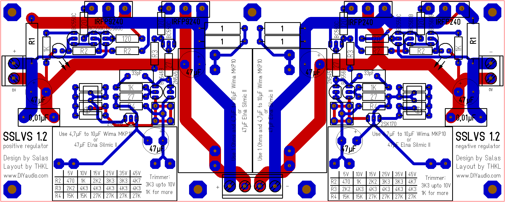

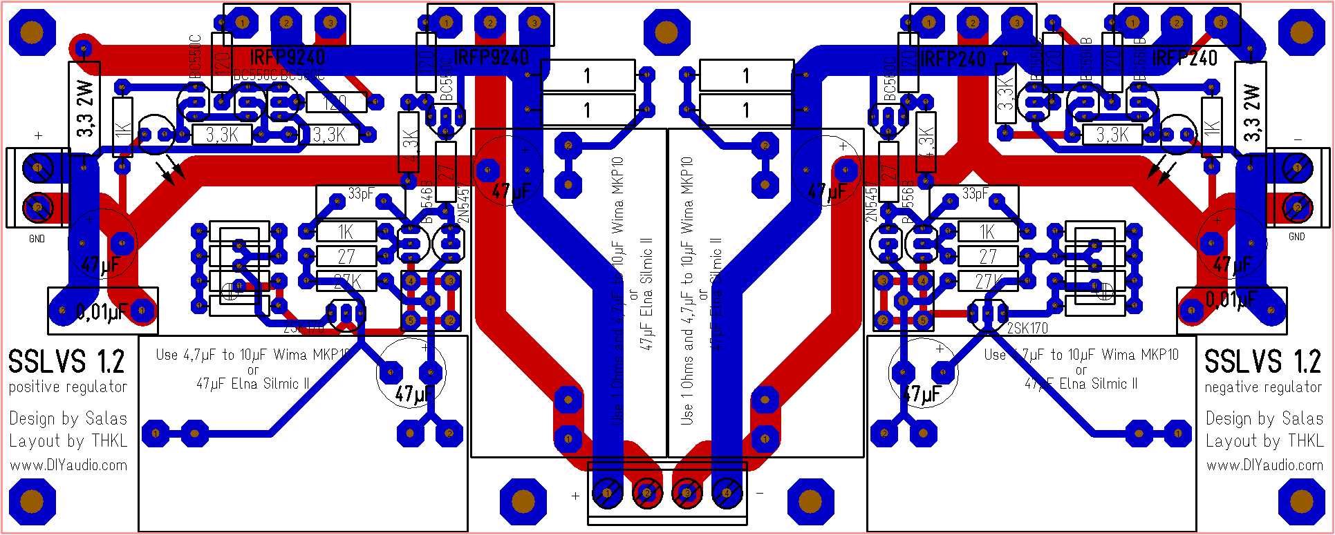

Another revision of the PCB:
- slightly changed layout for aesthetics (more symmetric)
- added table for different resistors for different output voltages
