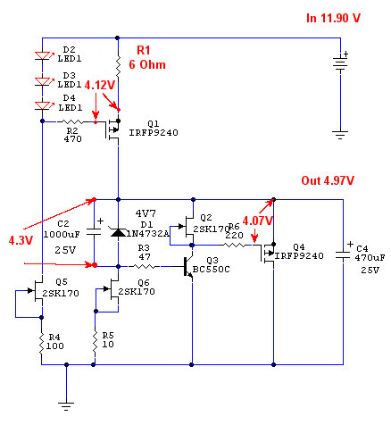

Is it the 3LED CCS? Shoot for Iset=2V/Rset roughly.
yes it is the 3led ccs. here is the attached scheme...will this reg work for my particular application which is 5v 3amp?thanks
You miscalculated. You meant 0.6R for 3A, not 6R. Must be a 15W resistor well ventilated. Use 2V LEDS since you got over 4V VGs, will come handy. Just any LED that has 2V Vf spec and can handle at least 10mA will do. That link is SMD capacitors by the way.
What is that thing drawing 3A at 5V? You must be very careful about dissipation, get a 0.56R, see the voltage drop across, the real current for your build will be exactly VR1/R1. You should need somewhat more left for the elements if you really will draw 3A constantly. Remember that your CCS Mosfet will need dissipate 21W no matter if the shunt Mosfet gives most of it to the load.

thanks for clarifying my mistake. the reg will be used for a squeezebox touch power supply. i will have it in a few days and thinking of upgrading it power supply. i think that it only draws 2 amp when the usb is not in use.

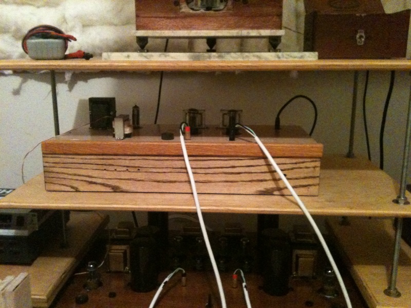

yes i do ill post the pic as soon as i get home. it doesnt look nice but it sure does sound very nice...ive built a couple, one for my brother.my build looks crappy and the wiring is messy.ill make a nicer one as i ordered parts to accommodate the hi v reg.and do it justice.

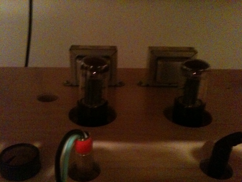

the ones on the pp 6v6 amp are new production tungs but the ones on the 6v6 pre are GE's i had lying around. those GE"S outperformed the current production Eh 6v6 in my setup.
it doesn't look as good as others have built. and the wiring inside is messy. ill post more pics on the 6v6line pre thread....
Hi Salas,
for that high CCS current >2A would it be useful to go to 4LEDs (~7V to 8V) to drive the CCS FET?
I think you will find a more stable FET voltage which in turn will result in a more stable Vr1 voltage.
I would also recommend at least 2 power resistors for that current. Keeps the current density around the resistor pads lower and thus less of a parameter change in the copper traces as they heat up.
For the 3A supply, 4LEDs @ ~7.2V and Vfet=4.1V leaves 3.1V as Vr1.
Now a pair of 2r2 power resistors pass ~1.4A each (4.3W each requiring >=7W Pd). A third trimmer resistor (~15r) can be added to give the desired CCS current if it needs to be higher.
