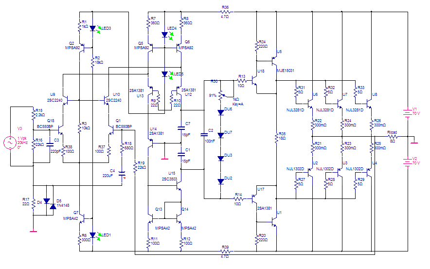

...and I get a tip (from member Megajocke) that Arrow is selling off the thermal track transistors dirt cheap, so I order some. Now, what to do with these? I think to change an existing design for these to work in but then I remember seeing...somewhere...an amp that is made for these. It looks complicated and it has some "features" that I don't want. I figure I can make a few changes so I go to the trouble of capturing the schematic in Multisim to try and get an impression of the performance. Very nice this amp looks in simulation and my changing the input from jfet to bjt didn't seem to make that big of a...
Enough of that. First, I'm not looking for any input here and I fully expect this thread to be ignored by many BUT I have something too good not to share. Admittedly, it is not original - I ripped off another DIY design for this (apologies have been made). I made changes. I corrupted the design and produced a truly offensive board layout. I made a prototype and populated it with unholy parts. I ran it and low, I saw that is was good- sing praise. 😀
In all seriousness, the schematic. Yes, it looks familiar.

AKSA said:
A very good amp, modelled on Roender's excellent amp.

Yes, I twisted his into a new animal. It has very similar performance across the board. I'll be posting results as I go.
ostripper said:
Is that a CFP driver setup ?? how would the EF oriented
T-track bias track tempco??
Is that why I noticed jumpered diodes in the Abomination
pix you posted??, to compensate.
OS
CFP like the original with the drivers running hot. They are all on the main heatsink along with the outputs. The TT diodes will track the temp. I have 5 of the 6 diodes in circuit but shorted one to allow for a lower idle current (50-60mA) to start. To use a higher idle current (140mA or more!) use 5 of the diodes. The schematic is not correct in this detail, I forgot to put the 5th one back in.

very good,mjl .I like that strange LTP/vas .. will "steal" it for sims.

BtW, Just for reference , is the general topology of this one a "balanced cascode"? I never followed roenders thread (too

That's it operating at the full +/-70 rails.
It's a folded cascode. I'd explain but I'm not sure I know how. Maybe Hugh could pop in again. 🙂
Here's 20kHz clipping performance from the actual amp. This is at full power:
Mild clipping shows no sticking. This is about 5Vpp over the amps input sensitivity.
A folded cascode is pretty much any common emitter amp which operates directly into a common base circuit.
That is, a LTP collector drives the emitter of the voltage amp, with the base kept at a constant voltage (just like any other cascode).
Chief disadvantages are:
More noise
Poor offset control
Reduced output swing
All you need to know about them is
HERE.
I still like 'em though, because they are fast. Could you replace the VAS current mirror with simple resistors, do you think? That would improve offset control, and remove an area of non-linearity, though at the expense of OLG.... (but you could pick that up again if the output from the LTP was buffered through an EF).

Thanks again,
I can't comment on noise (yet) but the offset is as low as I've ever seen - less than 1mV. Output swing is not an issue in my case as I'm not utilizing the full voltage potential of the power supply anyway.
It is supremely stable with next to no compensation and very well behaved.

I have tried a few different things, including resistor loads for the VAS, but all had a negative effect on the distortion spectrum - increases in the odd order harmonics, especially the 3rd.
It is the best amp that I have simmed (so far).

VERY nice amp, chief disadvantage of the folded cascode here is the lack of current amplification; any grounded base design will have current gain of one, which keeps OLG lower. This is, I think, the reason Mihai went differential, to pick up more OLG.

No criticism taken 🙂 I'm open to suggestions. I have tried out quite a few changes in an attempt to "improve" the circuit but it may well be as good as it can be. The biggest change I made was to convert the front end from jfet to bjt while maintaining the same current through the VAS. This wasn't an improvement but the main thing that I wanted to do.
I eliminated the cascode on the CCS for the LTP and with it an LED. Changed the cascode devices on the LTP to lower power units, but these still get fairly warm. Most of the devices are different from those in the RMI.

KLe said:
I was wondering what part the 2x 15pF of dominant-pole caps would be doing to keep the topology stable.
Hi KLe,
Not to understate my ignorance: I don't know. The simulation actually shows the amp to be stable without those caps. I haven't tried this with the real amp though.
