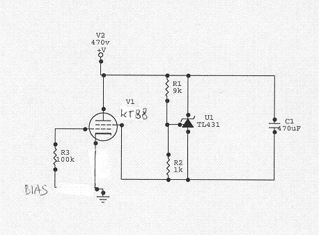

I've incorporated this 'trick' in my el84 se and must say that it makes an excellent improvement. My grievances before the mod were a somewhat slow, romantic but also muddled sound lacking attack; after the mod the amp sounds much more detailed and tighter. I wouldn't consider building another triode-strapped amp without using the trick. BTW the schematic contains a few small errors, ask me if you're really interested than I'll take a peek into my amp and see how I did it. fwiw Eddie Vaughn made a few suggestions for optimising the circuit (he uses something similar in his carina), namely using 5,6V zeners IIRC (same number would do the job) + one 1000µF electrolytic instead of the two 470µ and resistors. He also explains the benefits on his website (think he calls it black box).
Simon
This is the schematic
to me, that doesn´t make much sense from a technical viewpoint:
What is done there, is lowering Vg2 while maintaining the same AC swing at g2 as being present at the anode.
That means, theoretical possible total AC swing of g2 before catastrophic distortion havoc is lowered by 2 times the DC voltage drop from anode to screen grid introduced by this circuit.
In turn that means when using that circuit you limit usuable (not severely distorted) anode swing by the same factor, since AC swing still is the same.
This _may_ work for lowish gm pseudo-triodes to some extend and within limits, because the g2 DC voltage drop introduced will not intefer with the possible AC anode swing at its lowest possible value along the load line, but one would have to check each case in detail to make sure it actually doesn´t.
Anyway, this is not a good "general" recipe to use, since for correct triode-operation of pentodes you want the screen grid to be able to swing the full swing the anode may swing - in perfect synchronicity.
Besides that, it escapes me how a "g2 swing limited pseudo triode" can sound better than a "non g2 swing limited pseudo triode" - there is not the least traceable hint in this article why it should.
Actually, shifting Vg2 a little bit lower DC-wise while maintaining AC swing at anode and g2 only will shift the plate family of curves a little bit "horizontally" towards higher Va values; you can obtain pretty much the same effect by simply increasing the bias voltage slightly towards more negative values.
Tom Schlangen

I experimented with the "boosted triode" idea that was proposed in the EDN article. They used a 6L6 type tube in their article, so that is what I tried. The result, a dead 6L6GC. Their boost idea applies a positive (G2 higher than the plate voltage) offset to the screen grid. This does allow the plate saturation voltage to drop down to about 20 volts allowing slightly higher power on a lower plate voltage. What the article did not mention (and the authors may not have noticed) is the screen grid dissipation will be exceeded at idle and it will shortly melt. Mine lasted about half an hour. Do you want to run any 6L6 type tube with 400 volts on the plate and 500 volts on the screen, not for long. Their simulator (Microcap) will not melt but a 6L6 will! Been there tried that.
The Triode Trick pointed out in this thread is highly useful for operating sweep tubes in triode SE. Many sweep tubes have a low G2 max voltage which limits their usefulness in triode mode.
