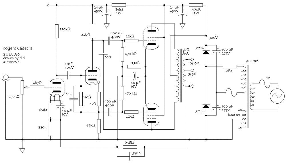

Hey all,
If I wanted to try this triode trick on a ECL86 tube output stage (as in schematic below) using the TL431 method, what voltage diff between plate & screen should I be using? In the schematic the voltage at plate is 300V and at screen is 285V I think - is this 15V the diff I should use for Triode use?
John
John
OK I think I've worked it out using the plate curves from the ECL86 datasheet - can somebody correct me if I'm wrong.
For triode operation point of 300V at 0.8mA anode current from the plate curves I get about -2.75V for grid below Anode which remains within the max dissipation of Anode of 0.5W.
So in the TL431 I need 100ohm & 1k Rs to give 2.75V
Questions I have if all of this is correct :-
the OPTs have a 9K primary - is this still OK for Triode op?
John
John
How can I work out the power which I could expect?
Hi John
The load output impedance is OK.
You can put a TL431 with 8k2 on 9k´s place for lower voltage drop(it is quite tolerant), but the bias will always change, because that, you need to know witch current flow trought the cathode resistor (to change the resistor), and I do a calcule with the data sheet at 70% of the plate disipation for AB operation, and with 22ma per valve is OK.

Thanks Cosme,
36mA is max current flow through Cathode so 22mA will be fine but 9K R will give me 27 volts & I think that with a cathode bias R in place of 270ohm the voltage comes out at about 12V.
SO according to this I should use a R1 of 4K - is my thinking correct?

John,
Do note that in the diagram given by you the lower screen voltage (and that to the earlier stages) does not have anything to do with sonic advantages as is the main subject here. It simply occurs because some form of smoothing of the raw dc is required to keep hum low (via the 470 ohm). If a choke had been used, the voltages would practically have been the same.
Generally:
I cannot see how a lower G2 voltage will give sonic improvement. One is going to pick up non-linearity somewhere at the low signal swing points. Also, the argument regarding say 100 - 200 ohms between g2 and anode - the g2 voltage drop for a 6L6 would only be an average of 1V! No way can I see that as making a difference. Make it larger, and the argument in my 1st sentence starts to apply.
Alternatively the higher than normal G2 voltage: What I would expect has been described by Tubelab and Tubes 4e4.
But "bottom line" to me: Why not UL? The graphs shown for the "enhanced triode" operation resemble those for UL. The circuit can hardly be simpler (perhaps the output transformer is slightly more expensive?). I also see no distortion measurements published - those for UL operation can hardly be improved upon by these tricks. I have no problem with experimenting (I was a researcher myself), but it appears to me that someone is trying to create an improvement that already exists. (As soon as I can get a scan I will post typical UL graphs - perhaps that will clarify the picture.)
