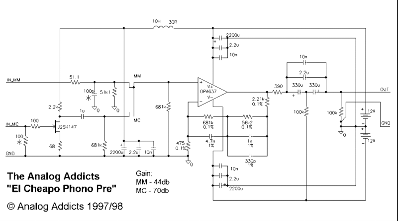

ultrasimple mm/mc riaa preamp
"EL CHEAPO" mm/mc riaa preamp
The Analog Addicts Phono Preamp
By Thorsten Loesch
It is also called "El Cheapo" (low price)
Hope noone will hang me, if I provide a schematic.
I have changed the size a bit, to fit DiyAudio.com.
Best is to read the whole article, that Thorsten Loesch have written.
See Link in post above!

Not much to say about this thing really. I started fafelling about with Selfs "Precision Preamp" Phonocircuit. It sounded BAD. So I messed about a lot and tried many things.
Doing this circuit with lead acid battery power, OPA637A and a 10k Pot (later an unusual active linestage with a FET Buffered LM6181 and Volume control with a 1k Shunt Pot and a 150 Ohm output resistor) sounded rather decent for solid state. Acrylic case BTW, mixture of hardwiring and PCB.
Still, I like valves and transformers better. Butafter you put don the long green for a pair of S&B TX-103 MC Steups and the same amount for the LCR RIAA EQ Module and shelled out the green for a PSU using 8pcs 10H chokes and 6pcs 120uF Film Capacitors you appreciate just how good this little job is for the money, how simple to build.
And the price of a pair of OPA637 plus a pair of 2SK147 and four 12V/2.1AH Lead acid batteries is not THAT outrageous. Hell, my current RIAA Stage clocks in at near £ 1,000 in materials uses near unobtanium NOS Valves and it is NOT ten times better than the little ugly duckling solid state stepchild. In wood, netal and all it looks a lot better though.
Sayonara

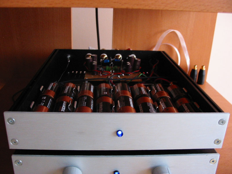

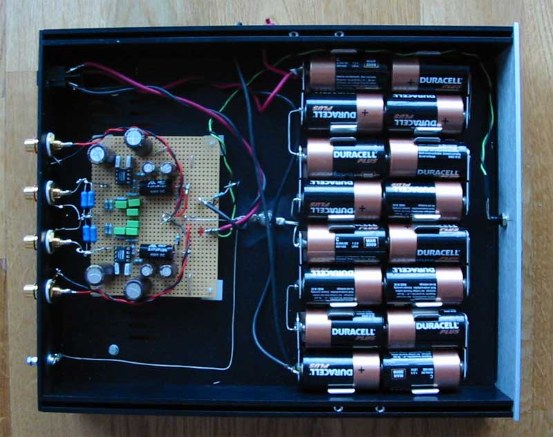

And here's how it turned out...
As I've changed the circuit somewhat I'm not allowed to say it's Thorsten's, but I think it is close enough.
Changes:
1. Only MM stage.
2. Not rechargeable batteries.
3. None of the specified components (brands) are used, except for the OPA637BP.
3. Supply filtering changed: Elna RJH 1000uF + 100nF Rifa MMK.
4. RIAA caps are WIMA FKP2, 2,5% but matched to exact value.
5. Outputcaps are Elna RJH 330uf (arranged as descibed) bypassed with 0,47uF SCR.

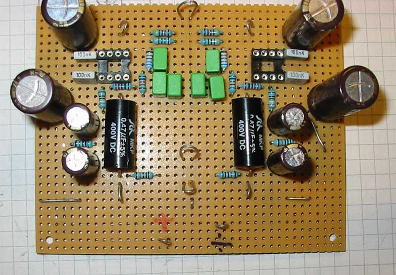

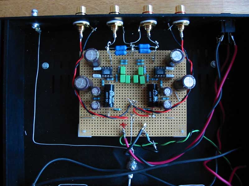

So, here comes the pics; board:

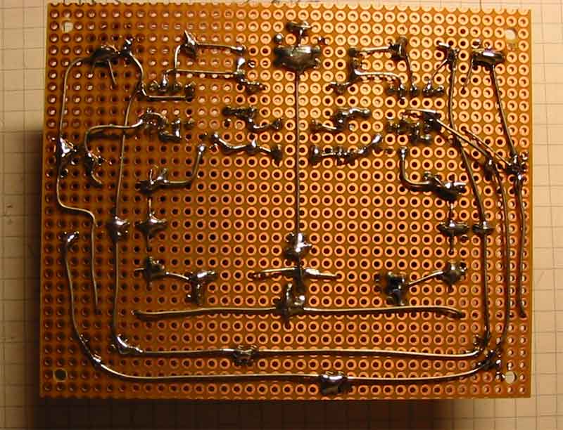

Hardwired my usual way. You can see that it was put together with a little haste. I know this is not the best way to build a circuit like this (PCB with ground-plane and p2p combo should be best), but it's my way..
backside:

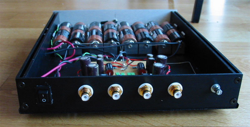

Maybe, you are wondering about the sound?
The answer is I don't really know yet, but it seems very promising; neutral, especially in the critical midband. A little relaxed, dark-sounding maybe. Very precise and accurate. Bass is solid, and treble is excellent. I've tried (and listened to) some of the other simple RIAA pre's, but always found something that I didn't like about them. Noise is as low as one can expect. I have to turn the volume all the way up and put my ear near the speaker to hear anything. Surface noise is also very low. Previously, I have always had a problem with static jumping through when changing records. Somehow it's gone now...?
This is the one for me, thank you very much :D
BTW, it worked very well with the OPA604 also ;)

Nice job. And good to hear you like the results. Some comments on sound later....
As you say, it's close enough. You can call it "Thorstens" if you like, though I think it is actually Mad_k's RIAA Pre and a nice one too.
Using Alcali batteries is still a battery supply, it qualifies too...
Consider adding more bypass capacitors. Try especially a few nF Silver Mica (say 2.2nF) and a few nF Styroflex or Tinfoil/Polystyrene (say 3.6nF).
This will be part of the "darkness". Try Silver Mica EQ Cap's instead. They will open up the sound....
See above. Bypass a little more. Add a Foil & Film Bypass and/or the Styroflex/silver mica combo.
Sayonara
Thanks for your comments Kuei Yang Wang!
As I am (was?) in the progress of testing different MM phono-pre's I did them all with the same type of components (more or less). I think you are right about the WIMA's, but I kind of like it..
