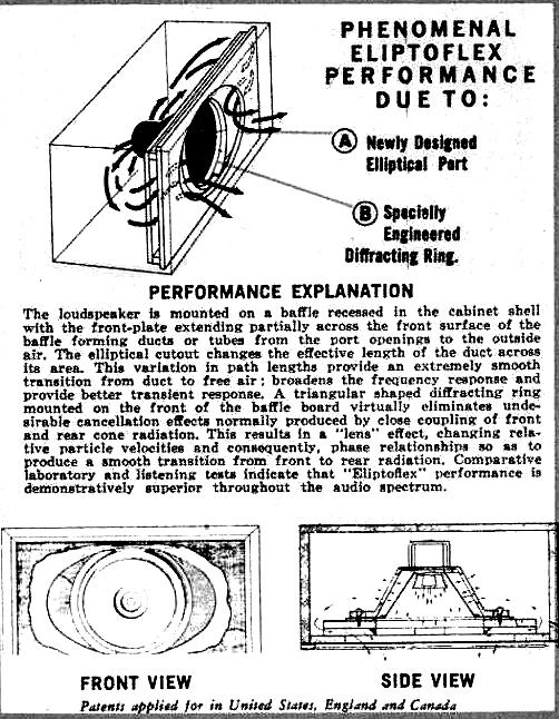

The internal sealed line must increase the radiation resistance that the driver sees over a wide band. This very much reminds me of the Eliptoflex (see attached) method of vent loading similar also to the JR reflex loading principal. I guess that the bends in the line generate turbulence which helps to increase the load of such a small line. How well this idea works is hard to say not having heard one but they exist and are being sold. The 6 moons review was of interest. I also see physical similarities to the S.A.F.E. loading method which had a series of vertically stacked plates with small spacing forming a kind of transmission line.
Any and all comments would be welcome. Regards Moray James.
