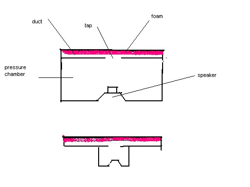

doing a proof of concept
Hi Moray, things have gonetohellhere last couple of days so I'm a bit scattered but
I was thinking about proof of concept.
I live in an apartment; don't have direct access to a shop or have much equipment, so I have to plan.
Need to prove:
That a narrow duct open at one end (the tap), lined with open cell foam on one side,
and pressurized by the tap leading from a sealed chamber pressurized by a speaker,
will reradiate measurable* pressure back into the chamber.
*Measurable defined as differences in speaker operation with and without the duct, and with and without the foam applied to the duct.
A box like one of those in the attached drawing?
Adjustable? Have to measure with and without foam, so it has to open. Possibly have to experiment with various depths and PPIs of foam.
I not too keen on the type of box in the picture I attached to my previous post because the size of the pressure chamber and tap aren't really defined - they're all run together. But might it do as a proof of concept? It's simpler to build for sure, and I'd just have to take the side off to change foam, etc. Im not sure whether coarser or finer celled foam would be best at capturing pressure at longer wavelngths - this is different than using it as an acoustic filter.
I'm thinking the duct has to be reasonably narrow to optimize pressurization effects in the foam.
I'm thinking this experiment should be small - using maybe a 3" speaker, but not junk. I think I saw something suitable with an aluminum cone in the Parts Express catalogue at @ $10 or under.
What do you think?

from a gut instinct level...
I like the version with the larger cavity. Don't really know why. Figure that the cavity acts a a perssure eq between the driver and the line. Would think that if we could find an engineer who has a major in the area of fluid mechanics that this sort of thing could be proved on paper no saw needed. That said a small unit (2-3 inch driver) should work to prove or disprove theory. Probably easier to measure response or impedance of the driver rather than pressure at the driver. Your guess is better than mine. Thanks for thinking about it. Regards Moray James.
